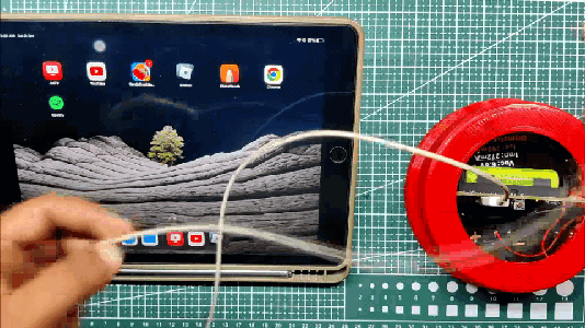

This is the SOLAR BANK which is essentially a power bank that has an onboard solar panel.
This SOLAR BANK can provide stable 5V output for powering XYZ stuff like an Arduino board or a Raspberry Pi Board. It can even be used to charge Smartphone or in my case an IPAD.
It contains a 3.7V 1200mAh Li-ion Cell that is connected to a Power Management IC Setup that takes the 3.7V from the cell and outputs 5V.
IP5303 IC is being used and it's a well-known PM IC that is widely used in small power banks.
The previous Version was this, I made a few major changes like changing the solar panel and creating a custom PCB instead of using a Power Management Module and I also added an SMD 18650 cell holder that holds the Lithium Cell directly on the bottom side of the PCB.

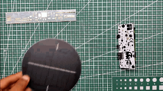

Step 1: CHOOSING THE RIGHT SOLAR PANEL
The previous Version had a rectangular Solar Panel that outputted 5V 200mA and based on its shape the overall body was made.
The Solar Panel that will be used in Version 2 is this Circular Panel that was made by OPEN GREEN ENERGY. (he's a friend of mine and gave me the panel for prototyping)
The diameter of this Panel was 130mm and it uses High-efficiency monocrystalline cells that had an efficiency of 19%.
Its peak power was 1.5W meaning it was better than the previous panel by 0.5W.
0.5W is not a lot but for a low-power application like charging a 3.7V 1200mAh cell, it will be sufficient.

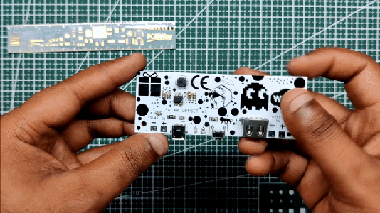

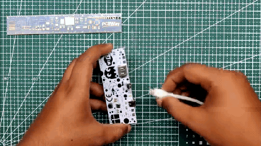

Step 2: PCB DESIGN- POWER MANAGEMENT IC IP5303
The Previous Version used a Power Bank Module that uses IP5303 IC so in this revision, instead of the whole module, its main IC has been used which is the IP5303 made by injonic.
A custom Board was made by following the wiring connections given in the datasheet of the IP5303 IC.
Here's the Datasheet- https://datasheet.lcsc.com/lcsc/1810151710_INJOINIC-IP5303_C181693.pdf

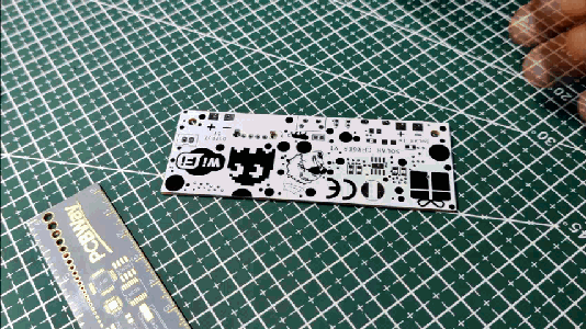

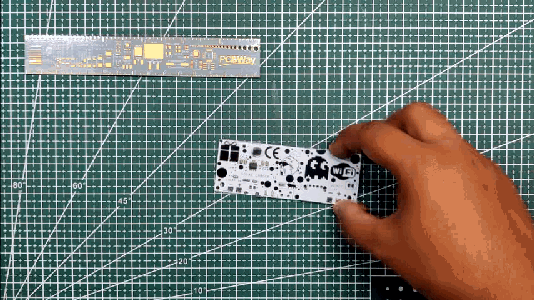

I finalized the schematic and then converted it into a PCB Design and later send the Gerber data of the PCB to PCBWAY for samples.

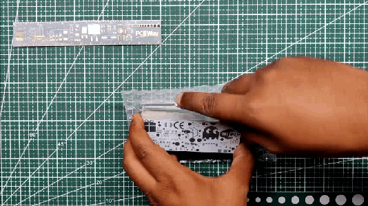

Step 3: PCBWAY
After completing the design, I uploaded the Gerber data on PCBWAY's quote page, selected the solder mask color which was White, and placed the order.
White PCBs look great with Black soldermask so that's why white soldermask was used in this project.
As for the aesthetics, I added a few random images and graphics on the TOP Silkscreen layer.
After placing the order, I received the PCBs in a week and the PCB quality was pretty great.
You guys can check out PCBWAY if you want Great PCB Service at an Affordable rate and low price.

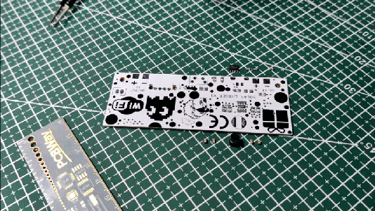

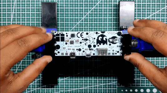

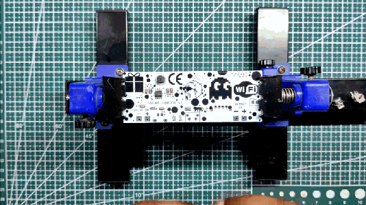

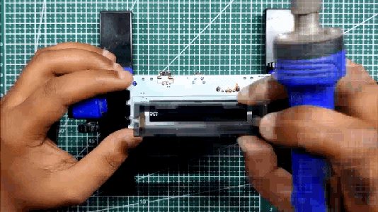

Step 4: PCB ASSEMBLY

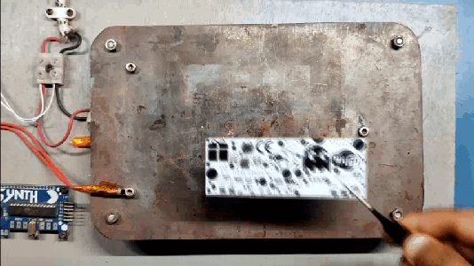

  • We start the PCB Assembly by first adding the solder paste to each component pad one by one with help of a solderpaste dispenser.
  • Next, we add components to their location by using an ESD Tweezer.
  • We then place the Board on the Reflow Hotplate for melting the solder paste.
  • After mounting the SMD components, we add the remaining THT Components like the USB Port, USB micro Port, Vertical Push Button, and SMD 18650, Cell Holder, by using a soldering Iron.
Step 5: RESULT OF THE SOLDERING PROCESS

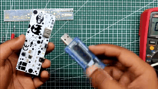

Here's the complete board.

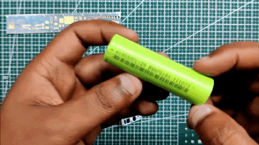

  • we place the 3.7V 18650 Lithium Cell on its Holder in the right polarity.
  • We press the Vertical Push button and the setup turns ON and the indication LED starts glowing which means the system is working.
  • Next, we connect a 5V Smartphone charger to this setup in order to check the charging cycle, current drawn, and voltage of charging.
  • We also connect a USB Tester on the output USB to test the output voltage which should be 5.1V.

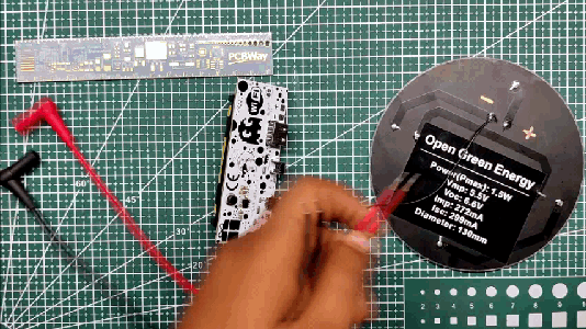

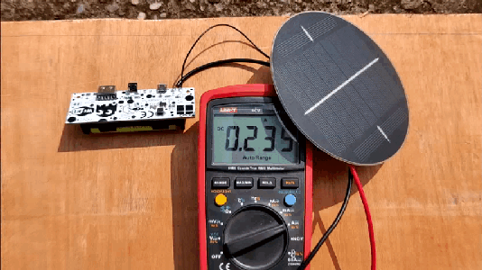

Step 6: SOLAR PANEL CONNECTION & TESTING
Now we add Solar Panel with Main Circuit by placing the Solar Panel VCC and GND to Board's solar IN terminals.
  • We also connect multimeter probes between the Positive of the Solar Panel and the positive of the mainboard solar IN terminals, this is for testing the Solar side power.
  • Next, we connect a multimer with this setup and put it in current checking mode.
  • After this, we place the Setup outside in bright sunlight and test the current drawn by the circuit which should be greater than 0.235A.
Current Drawn will depend on sunlight intensity and the position at which its been at rest.

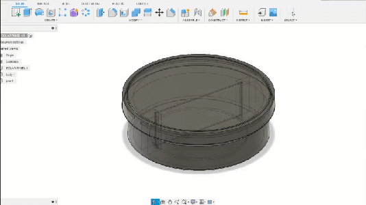

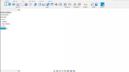

Step 7: 3D BODY
After testing the Mainboard and checking that it drawing power from the panel as well as the charger and also giving 5V Output, we prepare its 3D Body in fusion360 and then 3D printed it with a 1mm Nozzle and 0.32mm Layer height.
Because of its thick body, it will resist sunlight and heat a lot better than usual PLA. I do recommend using ABS or PETG for this.

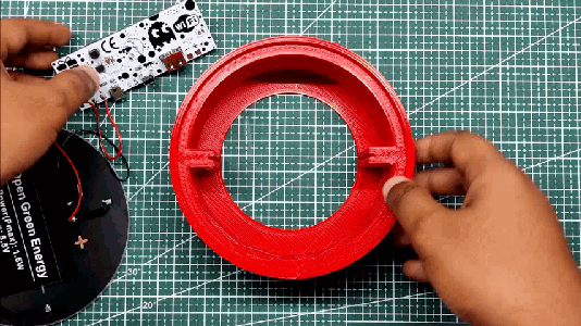

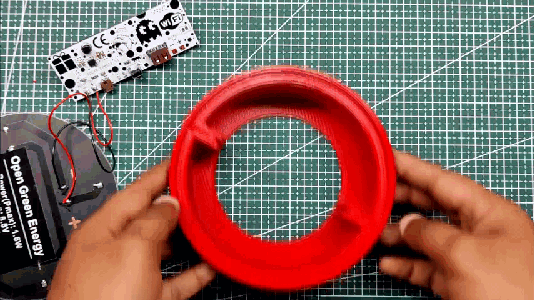

Step 8: MAIN ASSEMBLY

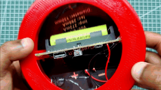

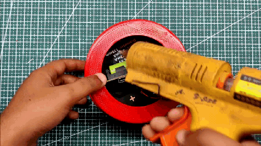

  • Main Assembly starts by first placing the circuit vertically into the body and then placing the solar panel in its place.
  • We then use Hot glue to secure the solar panel and circuit in its place.
  • and the project is completed, assembly was super simple.

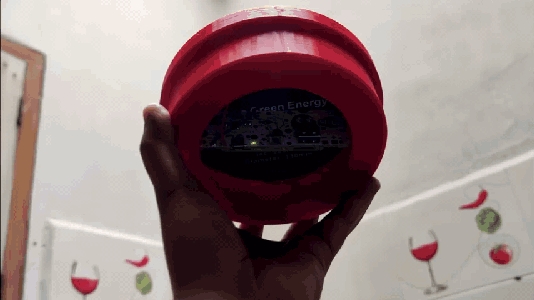

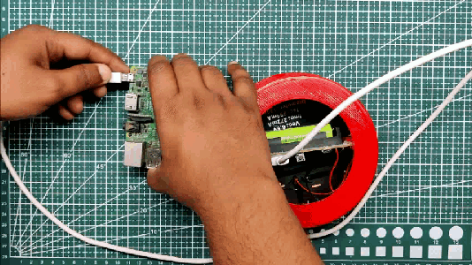

Step 9: RESULT
Here's the result of this build, Solar Bank is now ready for some basic testing which is to plug a USB Cable into it and power XYZ 5V Operated stuff.
