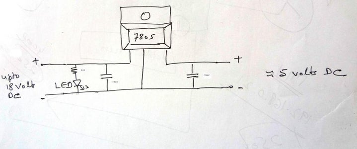

Step 1: CIRCUIT DIAG
BEST AND EASIES WAY TO HAVE T REGULATED 5 VOLTS , IS TO USE A CHEAP 7805 VOLT REG

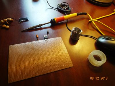

Step 2:

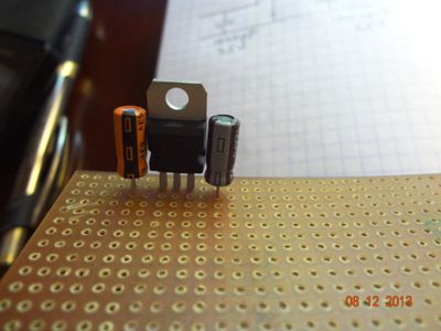

things required are
1. 7805 ic------------1 cost about 0.4 usd
2. 10mf cap --------2
3. soldering iron and plain solder board ,cost about 3 usd
If you like to add a LED , then one led and 3k ohm resistor 1/4w.
Please take care of the polarity , ie , positive of capacitor connected to + of supply .same for LED too.

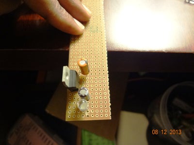

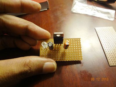

Step 3:
Mount the devices on the solder board , so that you can adjust and re position the devices for proper gap and soldering as per circuit.
Step 4:
Solder the devices , and then cut the excess solder board

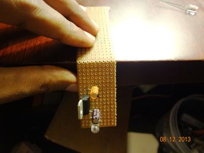

Step 5:
Finally cut the other part of solder board , just by bending on the table sharp edge

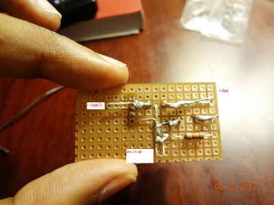

Step 7:
Now your circuit is ready and will look similar to this ,
you can keep this in a small box or on a wooden board to be safe .
