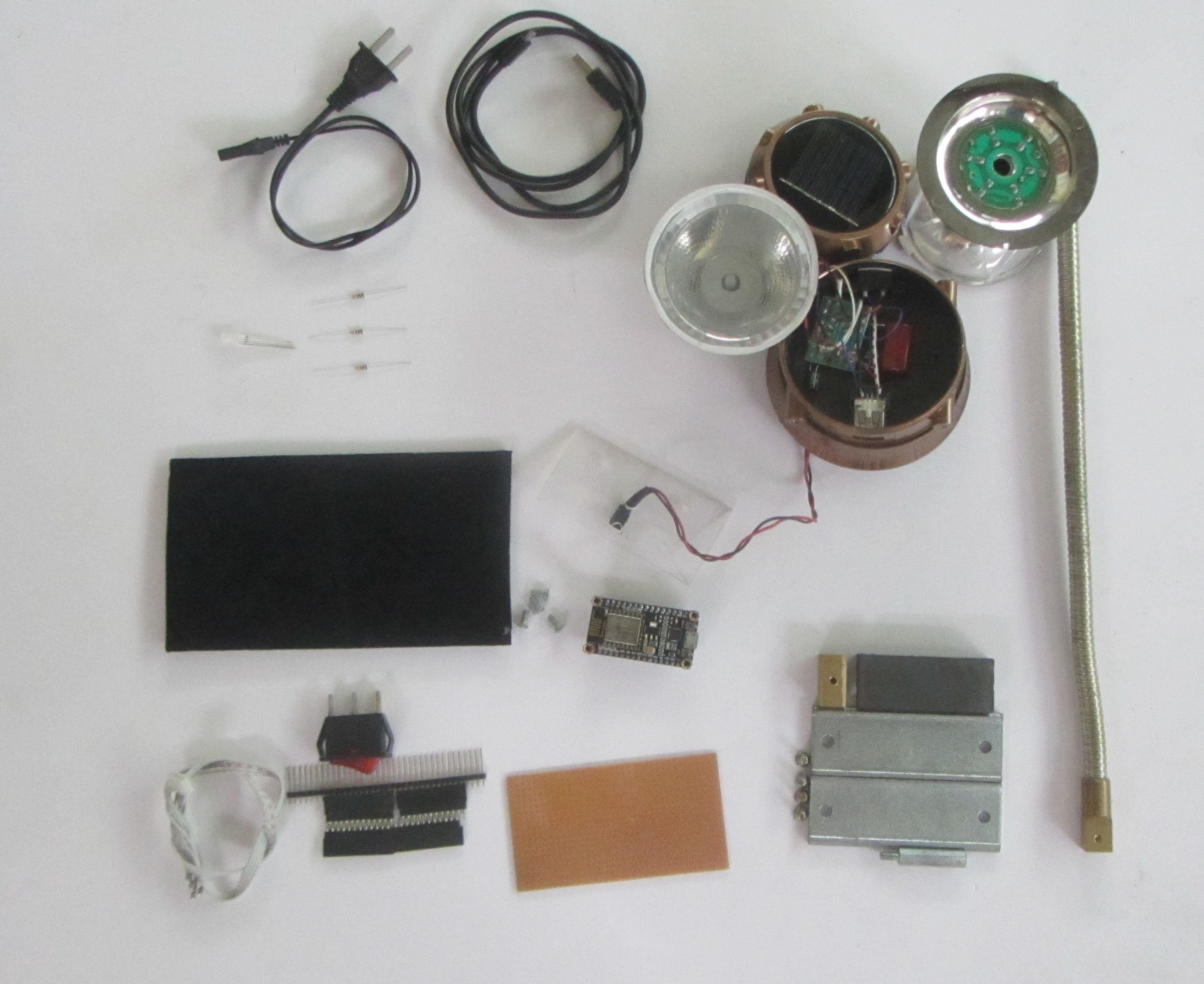

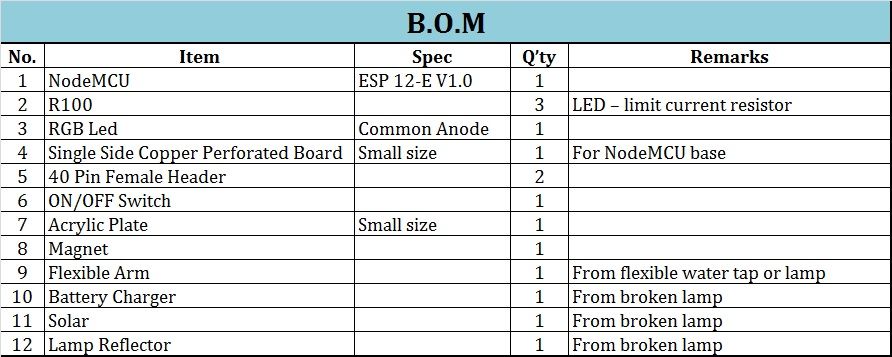

Step 1: BILL OF MATERIALS
B.O.M list:
For interactive mode, I use MPU6050 to get gyro data from NodeMCU to control lamp's color.
Materials picture for this project:

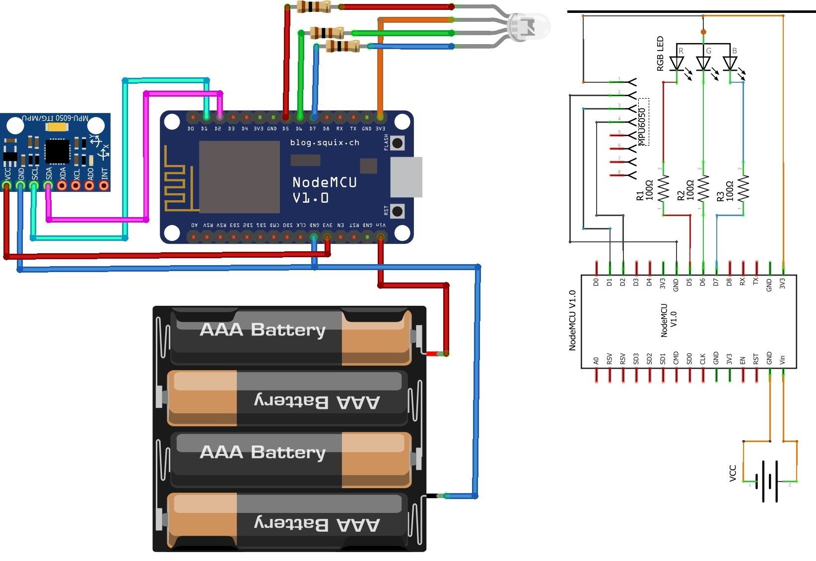

Step 2: CIRCUIT
This is very simple circuit, as Fritzing schematic above, with 1 RGB Led common anode type, three limit current resistors R100 & MPU6050.

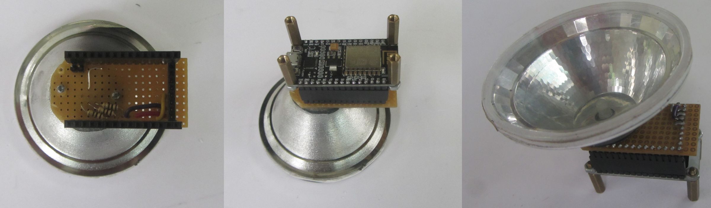

The reflector is used from any broken lamps & connected to nodeMCU base by 2 bolts or stick them with strong glue.
Installation work:
Schematic below:

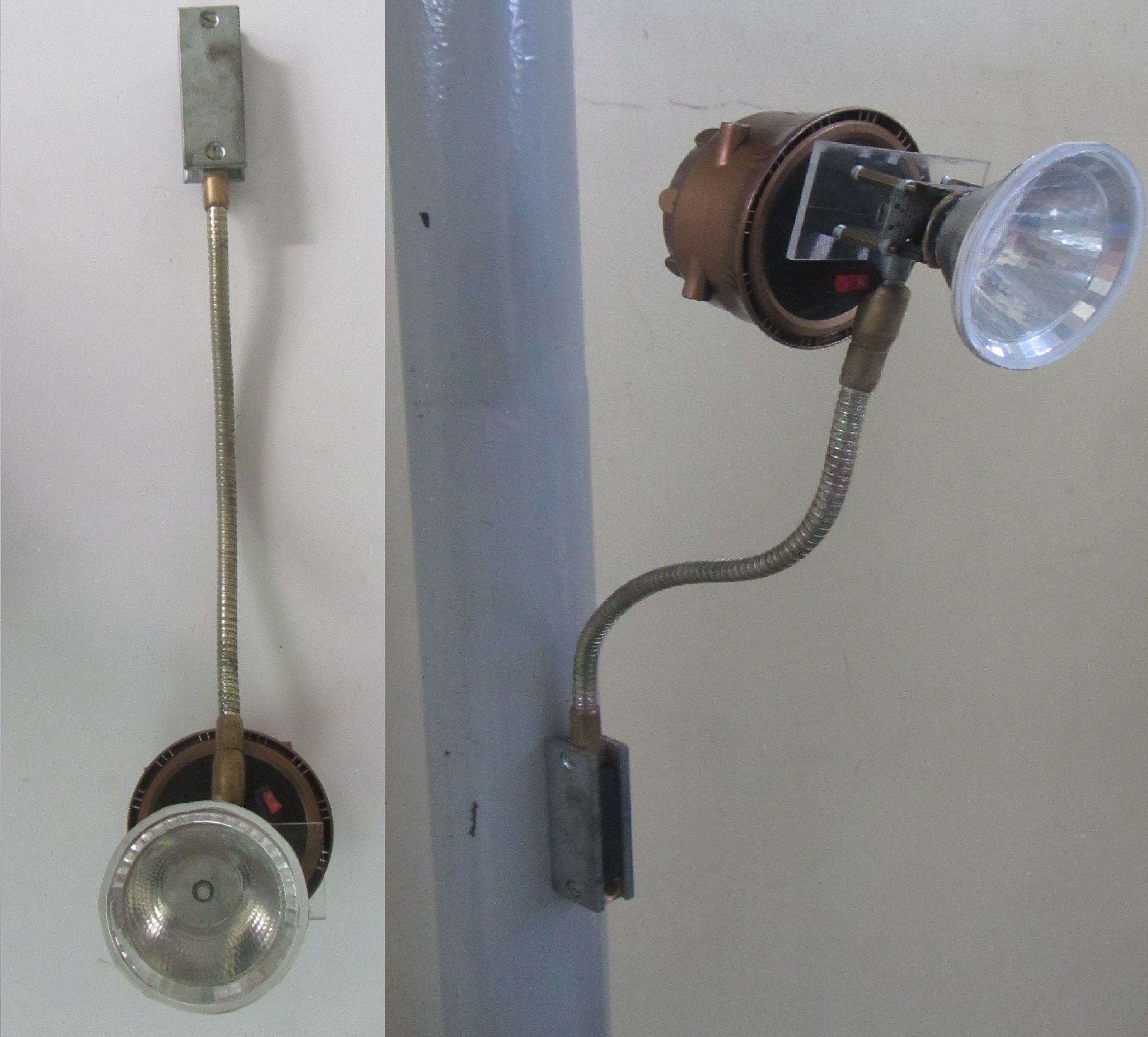

Step 3: MAGNETIC BASE - FLEXIBLE ARM

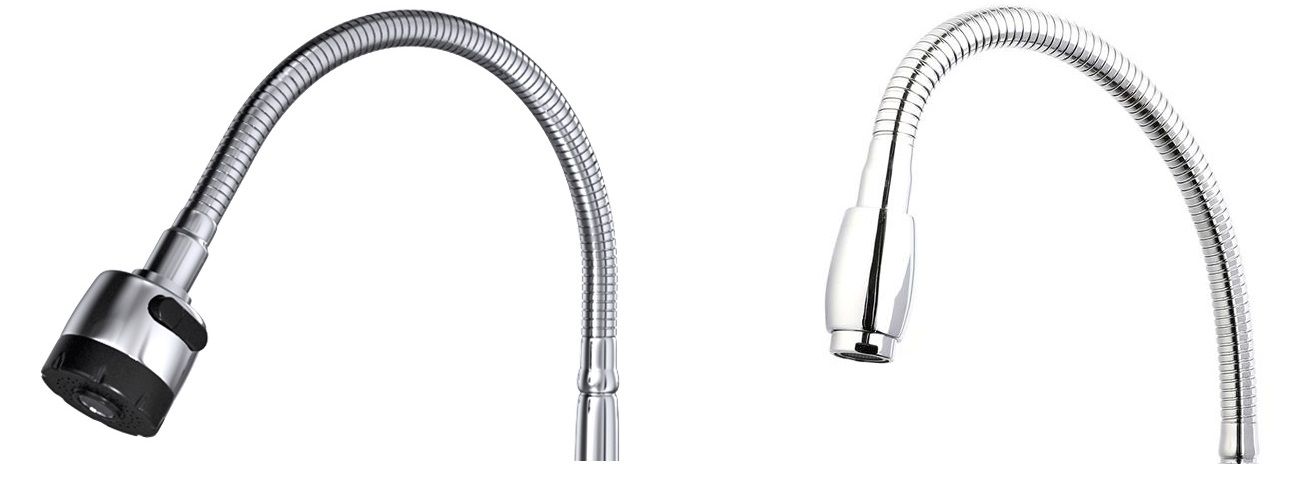

Flexible arm can be reused from broken flexible water taps. Something like that:
With some tips, we try to connect them to the permanent magnet base at bottom of flexible arm. On top, we made a drill hole for connecting to our circuit board and solar/battery charger.With this base, we can put lamp on surface like table, floors….; or it can be attached on magnetic materials like steel pillar, steel structure.

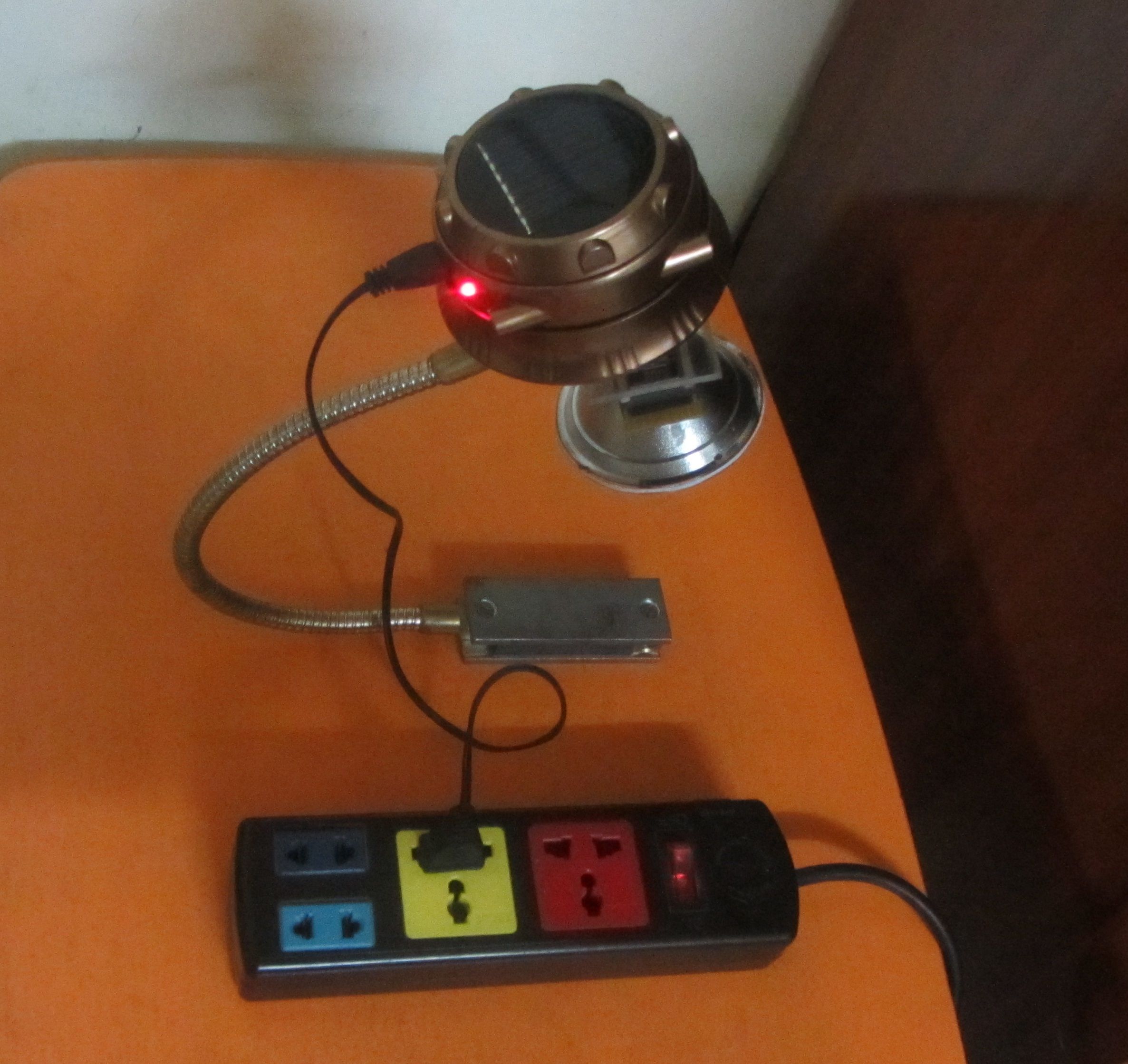

Step 4: SOLAR – BATTERY CHARGER
It came from a damaged charging lamp. I added an on/off switch and power wires supply to nodeMCU. It also has one USB port outlet and one plug for battery charger.
Step 5: CONNECT ALL TOGETHER
Connecting all parts: NodeMCU & reflector, solar & battery cells, flexible arm together.

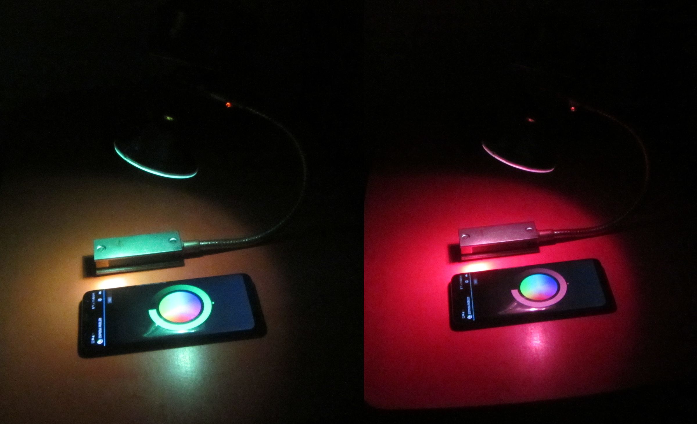

Step 7: WIRELESS CONTROL PROGRAM AND ANDROID APPLICATION
Another way, we can use Android App to control RGB LED with Android in WiFi Network. Link Android App:
NODEMCU control RGB LED APP
For Arduino program, you can refer to:
http://microcontrollerkits.blogspot.com/2016/05/es...

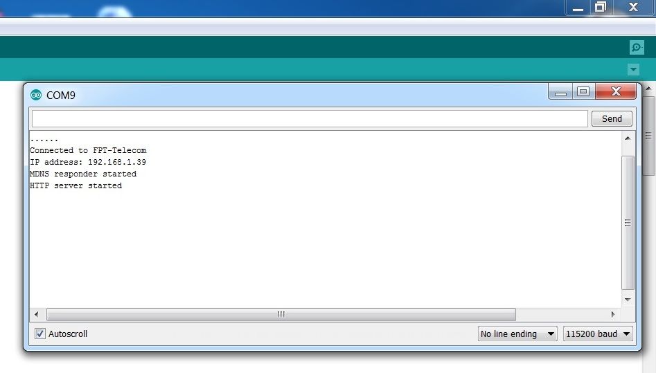

After uploading program to NodeMCU, the first run will give us the NodeMCU's IP address on serial print. In my case, it is: 192.164.1.39 at port 80.

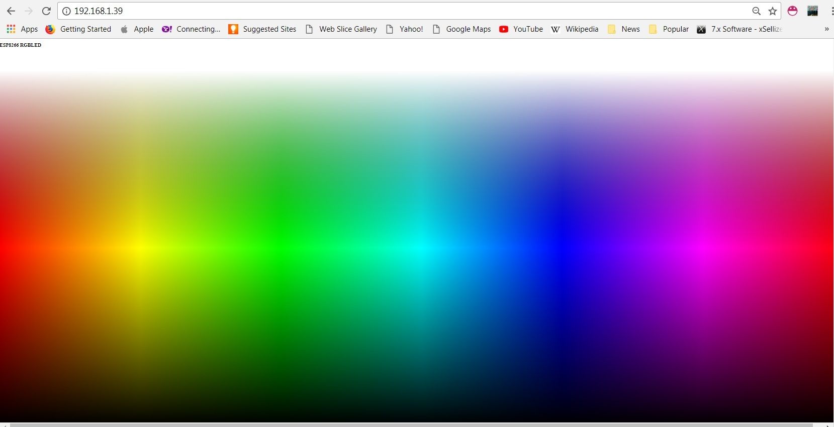

Now, we can control wireless lamp with laptop/ tablet/mobile phone by entering address above into internet explorer.
Or using Android app:
