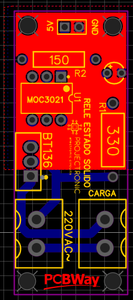

In this project we will make a solid state relay with an optotriac and a TRIAC BT136

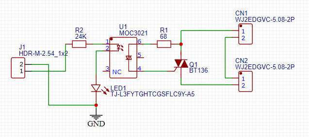

Step 1: SCHEMATIC DIAGRAM
We have designed the schematic diagram in the EASYEDA software where you can see all the electronic components of the solid state relay with TRIAC, it is a very simple diagram but very good for our projects.
Step 2: FUNCTIONING
Firstly, this circuit can be powered from a voltage of 3.7v to a 5v DC input to feed the optotriac or it can be powered from an ARDUINO or microcontroller and at its output we can control 220VAC loads.
when we energize the input with a constant signal of 5v we can activate the output and when there is a low signal 0v we will get the output turned off so we can control any circuit the rest is in your imagination what to do.

Step 3: TRIAC BT136
BT136-600E Triac 600v 4A
Bidirectional alternating current electronic switch useful to interrupt and/or continue the power supply of a device. Its versatility makes it ideal for controlling alternating currents, one of which is its use as a static SWITCH, offering many advantages over conventional mechanical switches and relays. It works as an electronic switch and also on battery.
TRIAC, 4P, 4A, 600V, TO-220
Peak Repetitive Off-State Voltage, Vdrm: 600V
Max tripping current (QI), igt: 10 mA
CT current state RMS (RMS): 4 A
Maximum representative surge current not Itsm 50 Hz Current: 27 A
Gate Trigger Voltage Max Vgt: 1.5 V
TO-220
3 pin
Step 4: ELECTRONIC COMPONENTS
  • 1 TRIAC BT136
  • 1 MOC3021
  • 1 LED 3MM RED
  • 1 RESISTOR 220 ohm 1/4w
  • 1 RESISTOR 330 ohm 1/4w
  • 2 BLOCK TERMINAL BLUE 2 PIN
  • 1 ESPADIN 2 PIN
  • 1 PCB
Step 5: PROJECT FEATURES
  • CONTROL VOLTAGE FROM 3.7V TO 5VDC
  • CONTROLLABLE FROM ANY MICROCONTROLLER OR ELECTRONIC CIRCUIT
  • I MAX INPUT 20mA
  • MAXIMUM OUTPUT VOLTAGE 660VAC
  • I MAX OUTPUT 4A
Step 6: EASYEDA
This project was made in the Easyeda software as we can see the tracks and the 3D image of the project working perfectly are no difficulty
