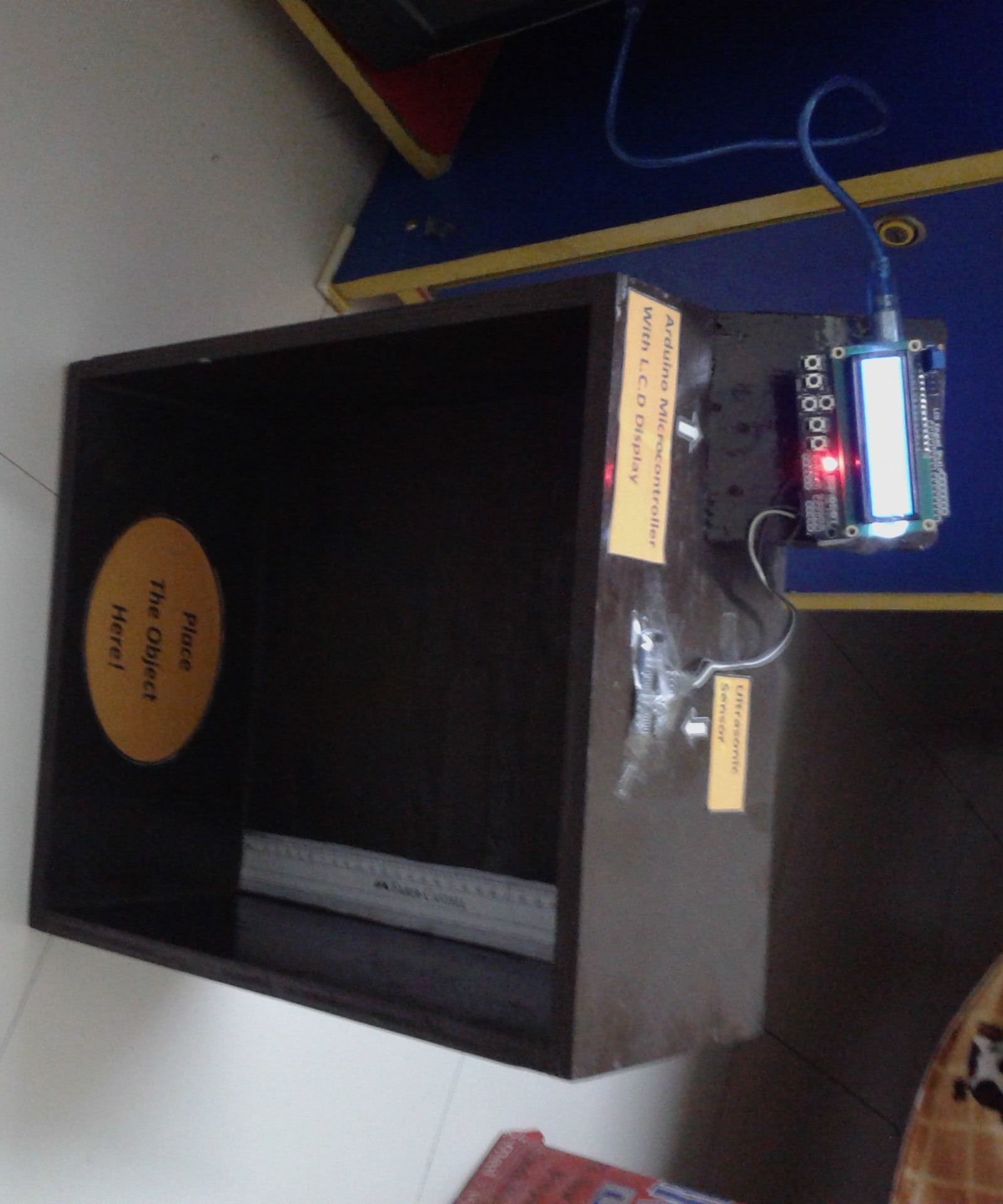

Step 1: Material Required
1.A rigid box
Here I've recycled a old shoe box.

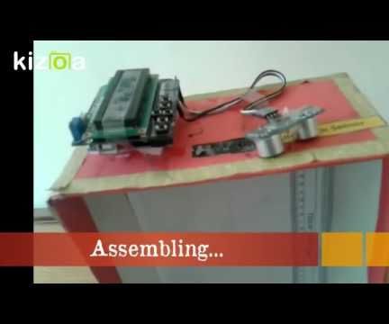

Step 2: Wiring
As simple as that.
Step 3: Program and Header File
If your Box if not 31 cm tall then look for the height displayed then change 31 to the height displayed,in:
" Height=31-(ultrasonic.Ranging(CM)); "(in the program)
if you are getting irrelevant results check if any wire is lose or not.
