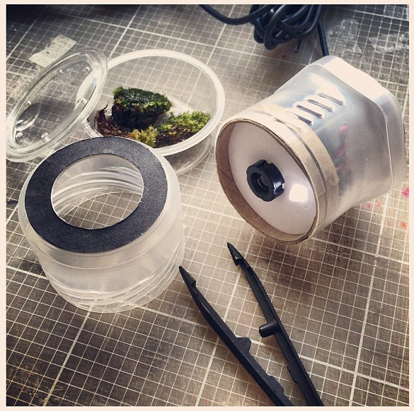

Step 8: Mount the Camera in the Twist Pack
Turn on your hot glue gun so that it has time to warm. Take one of your card discs and mark a point about 15mm from the centre of the disc then use a hole punch to create a small hole about 5mm in diameter. Now cut a hole in the centre of the disc just large enough for the widest end of the lens barrel (the 'capped' end) to pass through. You want this to be tight fit so try not to make it too large, about 12-13mm.
Remove the cap from the lens barrel (but keep the barrel attached to the circuit board so that it doesn't fall apart) and carefully insert it through the center of the disc (if the card has only one white side make sure this is facing away from the circuit board).
Replace the cap on the end of the barrel, and hold it flat to the card and secure with hot glue. Hold until everything is set, then pop the LED through the 5mm hole in the disc.
Take the USB cable and feed it through the top of the twist pack. Pull the cable through until the web cam sits in the tube and the card disc rests flat against the cardboard ledge on the inside of the tube. If the card feels loose you may want to add another strip of trimmed card.
Once you are happy that the card disc is in place, secure with a couple of strips of card stuck to the inside edge of the tube.
Step 9: Seal the Twist Pack and Finish Things Off
You’re almost done! Take another cardboard disc and draw a line through its center. Draw two more lines, 3mm above and below the center line. Using these lines as a guide, cut a slot out of the disc about 15mm long from its edge. Use this to hold the USB cable in place by slotting the flexible rubber piece at the end of the cable in to it. Do this before the next step.
Add some double sided tape or glue to the underside edge of the disc and fix it firmly to the top of the twist pack lid to seal it.
Cut a hole in the centre of the remaining cardboard disc, just smaller than the hole you cut in the bottom of the twist pack. Then, using some double sided tape or glue, firmly fix the disc to the bottom of the pack.
And that's it! You're done up-cycling a web cam into a super cool USB microscope with an easy to adjust focusing mechanism! Go grab yourself some things you'd like to exam up close and get exploring!
