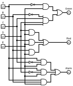

Step 3: Logic Simplifications: Expressions
From the outputs in the truth table, we pull the expression that make each output true. From here we can see which simplifications in binary logic transform each possible combination to have the desired output.
As seen in the picture, the simplified expressions are as follows. The "~" indicates that the input goes through a NOT gate first before being an input with the rest.
For the buzzer or the Alarm: A~CE + A~DE + ABE
For the Red LED: DE + CE + BE
For the Green LED: ~AE +~BCDE
From these expressions, this is where we derive the right connections to the right number of logic gates we need. So, let's put together the logic expressions from all the inputs and draw the connections we see from these expressions.
Step 4: Schematics
With the expressions we have written out, it's time to draw out the gates. In the picture above, you see the schematic that is drawn from the expressions we have written out using our knowledge in binary logic algebra. From each expression we see which logic combines which input or output. In the end, the total comes out to 9 AND Gates, 4 NOT Gates, and 3 OR Gate uses for these logic simplifications. The diagrams attached show 3 different ways for these schematics to be drawn out. They all have the same outputs but you can see the difference in context. The PDF file is the schematic from the actual build and it will be attached for each part of the build if that it easier to follow for you.
