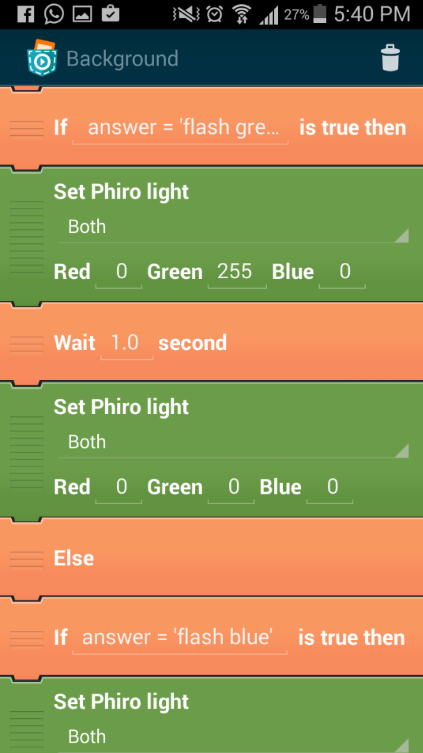

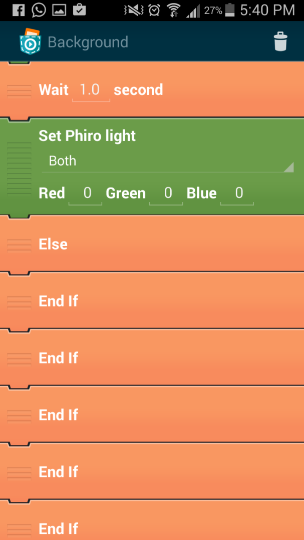

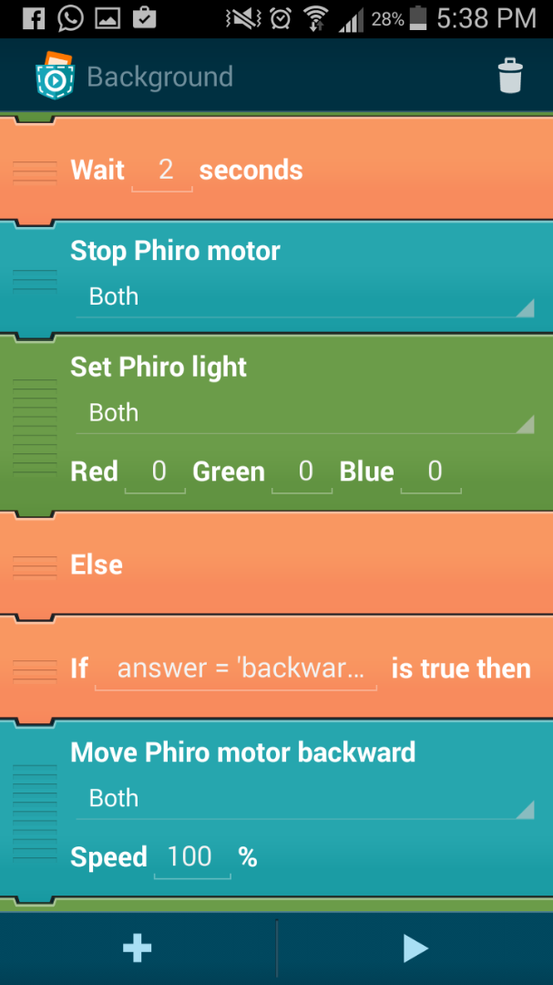

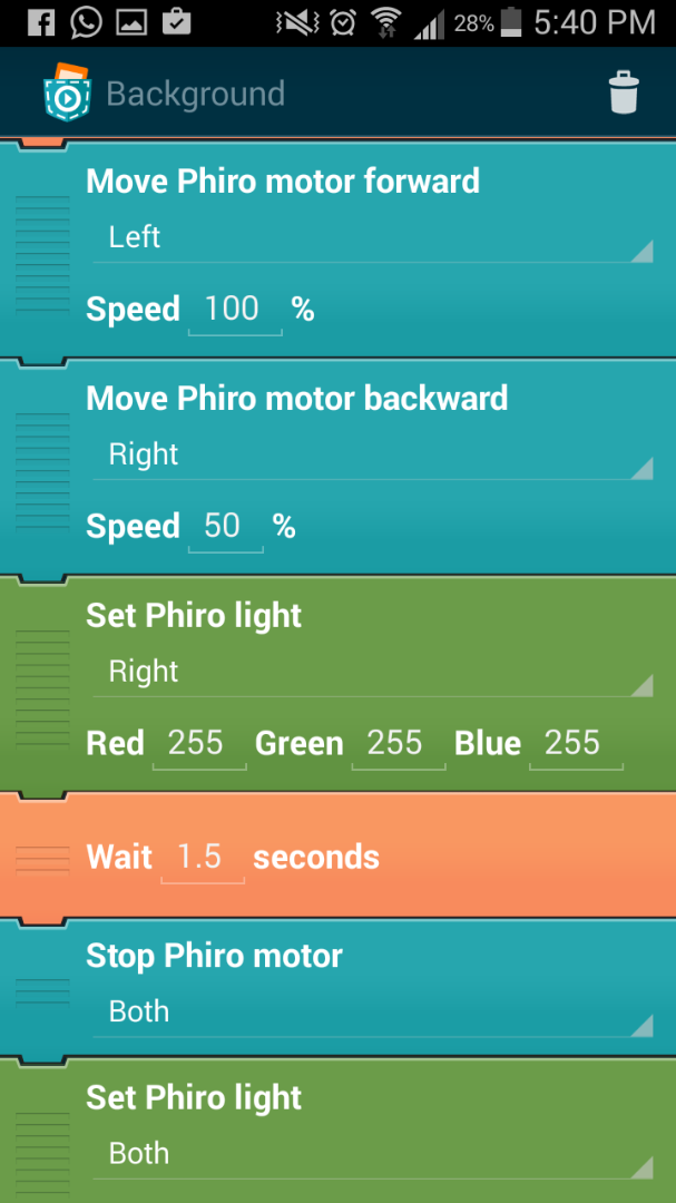

You can have a look at the picture that we used for our program.
We have also added the screenshots of the program for your reference.

3) Speak command - "Backward one step"
Move backward for 2 seconds (15cm)
4) Speak command - "Backward two steps"
Repeat twice the Move backward one step command
5) Speak command - "Left turn"
Turn left 90 deg (approx)
6) Speak command - "Right turn"
Turn right 90 deg (approx)
7) Speak command - "Flash RED"
Light up both LED's Red for 1 second
8) Speak command - "Flash GREEN"
Light up both LED's Green for 1 second
9) Speak command - "Flash BLUE"
Light up both LED's Blue for 1 second
