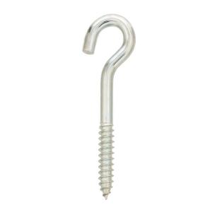

A 3/8" Lag Bolt.. I had a lag eye

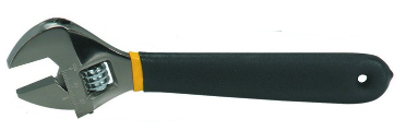

A 6" or bigger Adjustable Wrench under $4.00

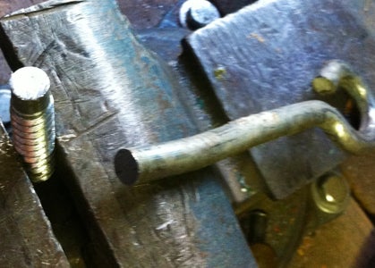

Step 2: Cut and Prep the Lag Screw
Place the Lag bolt firmly in a vice and use a hacksaw with a 24 TPI ( a good ) metal cutting blade
and cut the Lag bolt about a 1/4" above the threads..

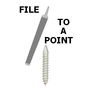

Now take a file to both sides of the stub forming it to a flat point as the fifth and sixth pictures show.
This prepares the Lag screw for easy welding..

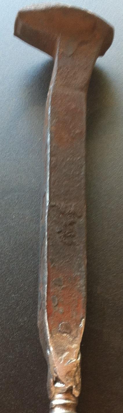

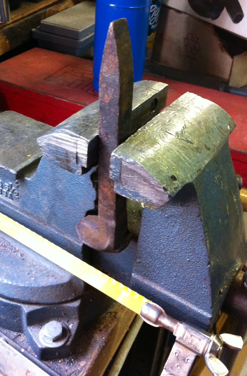

Step 3: PREPARE THE RAILROAD SPIKE TIP
The sharp end of the spike needs a small V cut into it to capture the Lag bolt.
Simply cut the V into it using the hacksaw and maybe use the file to adjust a fit into it.
This makes the welding a snap for anyone.

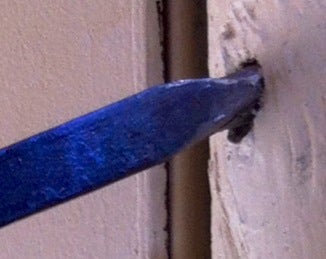

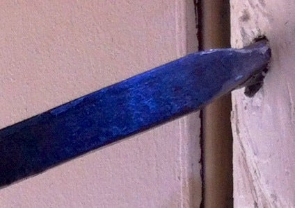

Step 5: USING THE SPIKE OUTDOORS
To mount the Railroad Spike on a suitable post or 2x4 stud.
Use a 3/8" wood or spade drill at about a 15° down angle and
drill a hole, just short of the threaded Lag bolt segment length.
Screw the Lag Railroad Spike, helped along by a wrench into the hole.
Stop when the Railroad Spike Tip is hook-up and just touching the wall.
Finally... Hang a Lamp on the Spike Hook...
Men do seem to notice the incongruity of the suspension first :-)
