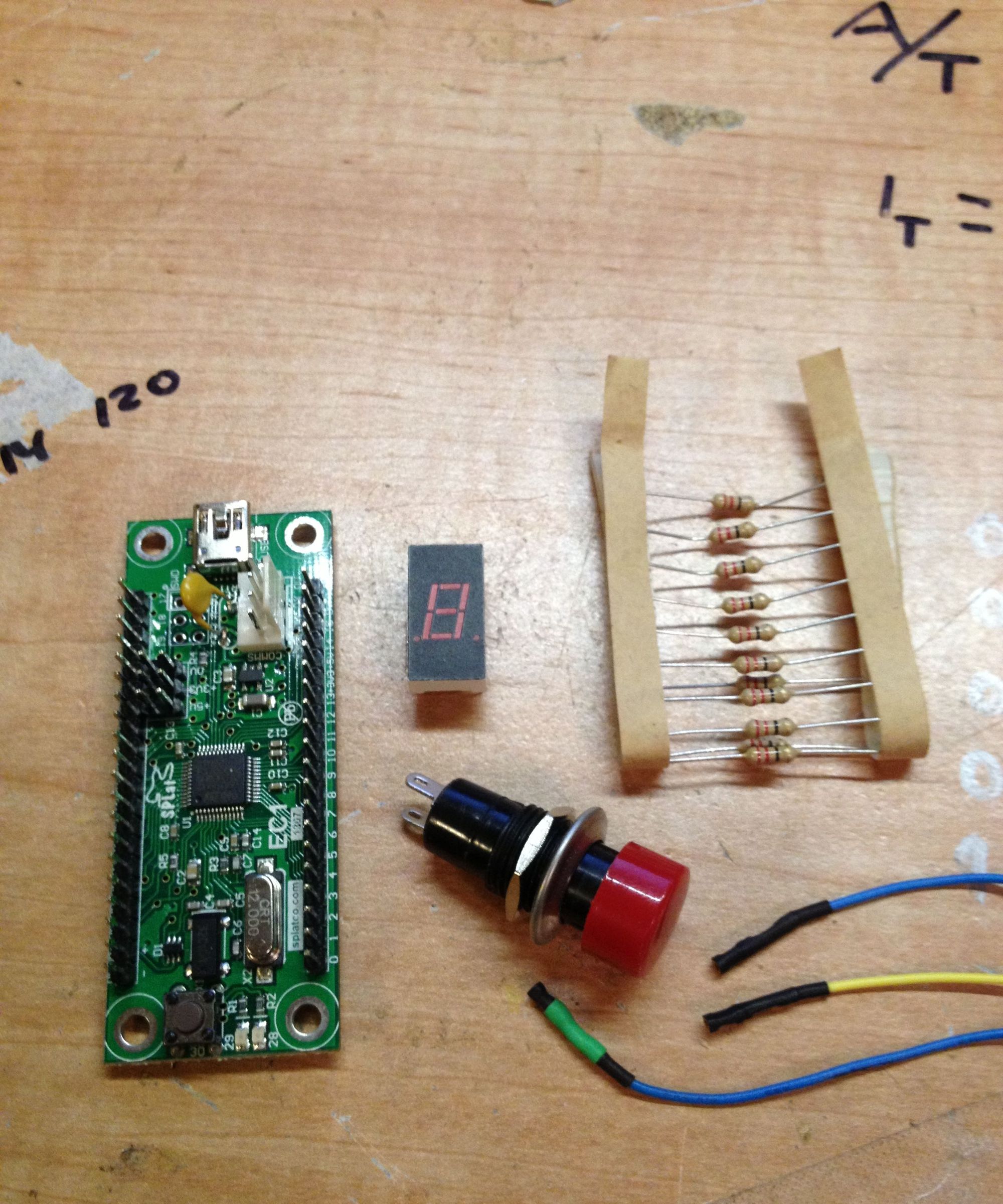

1 LED common cathode bar graph or equivalent 1.8V forward voltage and 10mA per LED (I use multiple rectangular leds glued together and negatives soldered together)
8 33 ohm resistors
Female header connectors
Multimeter
Solder
Soldering iron
Solid speaker wire
A computer running SPLat/PC, the free SPLat programming environment (IDE)

Now lets plug in our LEDs to the EC1 in order red to green pins 6-13 (outputs 2-9) these will be programmed to turn on at different voltage levels, also plug the common cathode into the 0v pin
We can also plug one test lead into the 0v pin and the other to pin 3 (analog input 0)
Now lets plug in our EC1 to a PC and connect to it while running SPLat/PC
