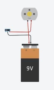

Next insert the switch into the front hole.
Use the red wire from the motor and connect it to the switch as shown.
Connect the negative wire from the battery to the switch.
Wire the red wire from the battery to the negative side of the motor.
Note: The reason why the polls are reversed is to ensure that the motor pushes air instead of pulling air.
