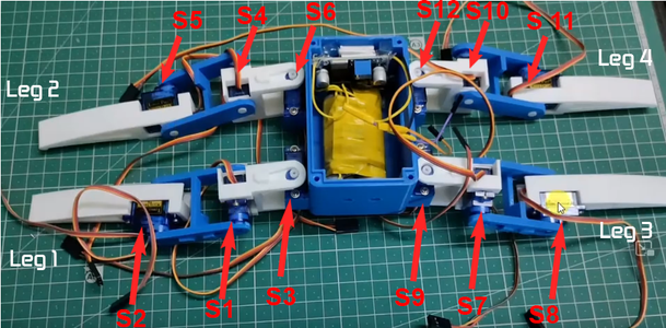

Step 4: Attaching Servo Motors on the 3D Printed Parts
After printing the parts, you need to attach SG90 servo motors with the 3d printed parts.
Step 5: Connecting All the Body Parts Together
Then, all the 3d printed body parts need to be connected together through the servo motors.

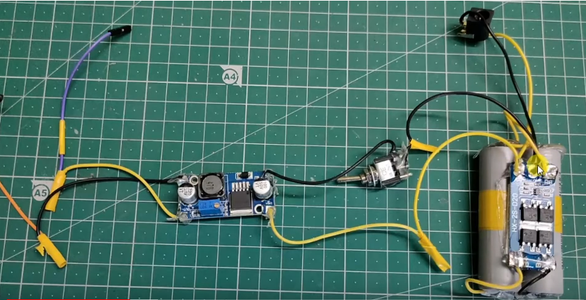

Step 6: Attaching Battery and Battery Management System
Then, the battery and battery management system need to be attached in the body of the robot. As I have connected two lithium-ion batteries in series, I was getting around 7-8 volts. Thus I used LM2596 buck converter to reduce the voltage to 5 volts, so that using this single power source Arduino, servo motors and Raspberry Pi can be powered.
Step 7: Connecting Arduino in the Robot
At first, Arduino nano need to be attached with the I/O shield and then all the servo motors need to attached with the I/O shield. While attaching the servo motors, make sure you have attached them according to the numbering mentioned in the servo numbering figure and circuit diagram figure.
