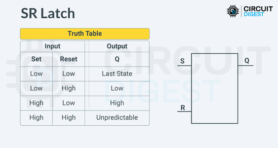

Step 1: What’s an SR Latch Anyway?
Think of the SR Latch as the sticky note of digital logic. You tell it something once, and it hangs onto that info until you tell it otherwise.
  1. S (Set) = “Write a 1.”
  2. R (Reset) = “Write a 0.”
  3. Q = The note it’s holding.
The beauty is that once you set or reset it, the output sticks. Even if you stop giving it input, it remembers. That’s why it’s the smallest, simplest form of memory in digital electronics.
SR latches can be built from NOR gates or NAND gates. The only difference? NAND ones use “active low” inputs, so the signals look inverted compared to the NOR version.
Quick note before we go further: Add a clock pulse to a latch, and suddenly it becomes a flip-flop. Same family, slightly different behavior. Engineers argue about terminology, but just remember: flip-flops are the clocked cousins of latches.
Step 2: How This Thing Behaves
Alright, here’s the simple logic rundown. (Imagine you’re flipping a light switch with weird rules.)
  1. S = 0, R = 0 → Nothing changes. The latch holds its last state.
  2. S = 0, R = 1 → Reset mode. Output becomes 0.
  3. S = 1, R = 0 → Set mode. Output becomes 1.
  4. S = 1, R = 1 → Whoops. Invalid state. Both outputs fight each other, and chaos ensues. Engineers pretend this state doesn’t exist.

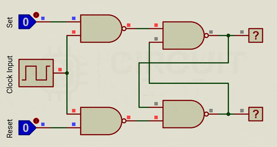

Hobbyist tip: If you want to try this on real hardware, grab a 7400-series NAND IC (like a 7400 quad NAND gate). Wire two of them up as cross-coupled feedback loops, and you’ve got yourself your first physical latch.

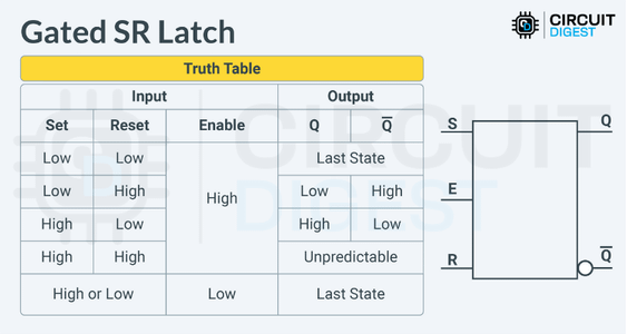

Step 3: The Gated SR Latch (With Parental Controls)
The basic latch is always listening, which is fine… until it isn’t. Sometimes you want it to pay attention only when you say so. Enter the Enable pin.
This version is called the Gated SR Latch.
  1. When Enable = HIGH, it behaves like a normal SR Latch.
  2. When Enable = LOW, it ignores you and just holds the last output.
Think of it like talking to a kid with headphones on. If Enable isn’t active, they don’t hear your Set/Reset commands.
Step 4: Clocked SR Latch (Now We’re Talking Flip-Flops)

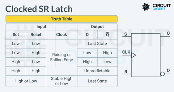

The last variation we’ll look at is the Clocked SR Latch, which most people also just call an SR Flip-Flop.
Instead of an Enable pin, you’ve now got a Clock input. This makes the latch edge-triggered, meaning it only updates when the clock signal ticks (rising or falling edge, depending on design).
Why does this matter? Because in sequential logic, timing is everything. You don’t want memory changing randomly; you want it synchronized with the system clock.
Here’s how it behaves on a clock edge:
  1. S = R = 0 → No change.
  2. S = 1, R = 0 → Set Q = 1.
  3. S = 0, R = 1 → Reset Q = 0.
  4. S = 1, R = 1 → Same invalid nonsense as before. Don’t go there.
