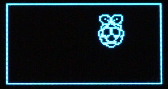

I've been playing with the new Raspberry Pi Pico microcontroller and have been using it to drive a cheap and simple SSD1306 display with 128 x 64 pixels.
This Instructable will show you how to install the necessary driver, connect up your Pico and the display, draw text, lines, rectangles and circles on your screen, bounce an icon around the screen and print a scrolling message in a Sine curve.

This part bounces the raspberry icon around inside the box and does the calculations for the last section by defining a path on which to display some text.
