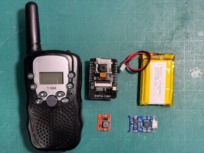

As always, here are the components you need to test your project. These are the ones I used, but if you have other radio equipment for example there would be no problem to replace it... in the end we only need to send audio.
On the other hand, regarding the batteries to power the system, we will talk about them later. The link I have left would be the best option but it doesn't have to be the only one. In fact in my last successful flight, I didn't use that system and I didn't find any problem either.
List of components:
-1 x PMR 446 walkie set Not to be confused with model 462 (Link)
-1 x ESP32-CAM + programmer (Link)
-1 x Switch (Link)
Option A power supply:
-1 x 4xAA battery holder (Link)
-4 x Lithium Batteries (optional) (Link)
Option B power supply:
-1 x Lithium Charger TP4056 (Link)
-1 x DC-DC 5V booster (Link)
-1 X Lithium battery 3,7v 1500mah (Link)

For this project we propose the use of PMR walkies, surely you have seen them at some time as it is very common to find them in shopping centres or sports shops. These radios have the particularity of not needing a licence to use them, for this reason it is not allowed to modify their antenna or increase their power from 0.5w. However, although the boxes promise a range of 3-5km, we will be able to send signals up to 30km. This is because the signal travels directly from the transmitter to the receiver as it is at a high altitude and does not have to pass through buildings or mountains, in other words there is a direct line of sight between transmitter and receiver.
When you dismantle the radio equipment you will find a board very similar to the one in the image. All we need is the circuit on the top of the walkie next to the antenna. Don't lose sight of the rubber button panel as we need to set up the radio correctly.
