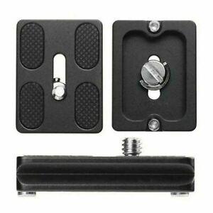

- Arca Swiss Plate

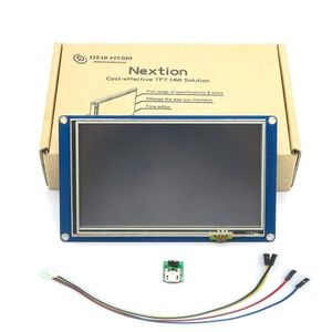

- Nextion Screen TFT NX4827T043

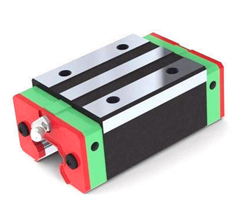

- Linear Block HG15CA(2)

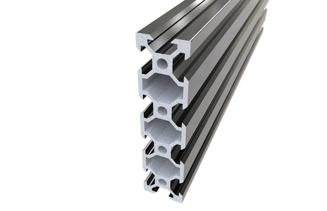

- V Slot 2080x30cm

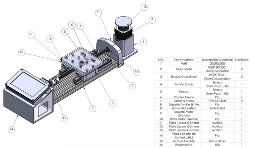

The supplies of the automatic capture system are shown in the CAD picture, which were chosen based on the application. Besides, linear guides are used with the purpose of minimizing the vibrations in the motor and the reflex camera mirror that was used.
The dimensions of the reflex camera and the minimum focus distance of the lens are important to obtain the length of the rails. In this project I work with a Nikon d7200 camera and a YONGNUO YN60mm F2NE MF Macro Lens with a 0.8ft minimum focus distance, so the rail has a dimension of 25cm~0.9ft.
It is necessary to have an Arca Swiss plate to hold the camera to the frame.
In addition, there are two stepper motors:
The first one that moves the camera based on the depth of field.
The second one that rotates the plate where the object is. This allows us to achieve images around the object.
Finally, the power screw used is a T8 with a 2mm pitch thread which means when the motor makes one turn, the camera moves two millimeters. This combination with a nema 17 stepper motor of 200 steps per one turn makes that the camera moves 1mm every 100 steps.

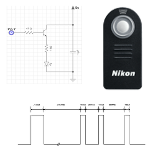

Taking advantage of the fact that the camera has an infrared receiver, we are going to capture the circuit of an ML-L3, and connect it directly to the microcontroller so a photograph is taken after the stepping motor finishes the depth of field trajectory. This process will be repeated until covering the entire dimension of the object.
The plot of the ML-L3 circuit was taken from the next page, there you can get more information, and a controller output with an IR led was used.

The process is carried out from a Nextion screen where the system starts working.
First, the lighting is turned on, then the dimension of the object is registered and on the screen we will check the progress of the process.
Important to know that the process can be started from the computer as well, however for this example we work with a screen so the process can be carried out autonomously.

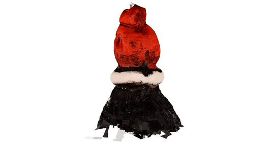

When we have all the pictures taken, we use the combineZM software to perform the focus stacking and obtain all the images from all angles of the object in order to obtain the three-dimensional reconstruction in the RealityCapture software.
Step 6:
It is recommended to take as many photos as possible and a lot of photos from all angles of the object to achieve a good quality stack. We can modify the number of pictures taken in the code which is shared in this instructable.
In conclusion, with these characteristic information we can reconstruct small objects such as an Ecuadorian Condor handicraft of just 12 mm, which was successfully reconstructed with a total of 36 photographs.
