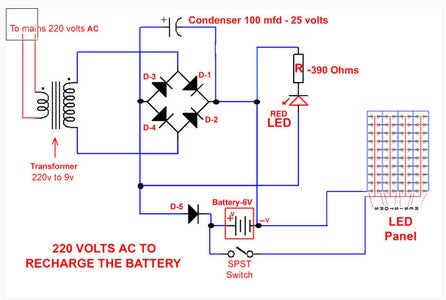

Step 4: Wireing the Charging Unit Circuit.
STEP-4
Follow the CIRCUIT diagram and assemble the charging unit.
FIVE --D1 to D5 are Diodes. IN4007 DC.
ONE --Condenser 100mfd 25volts.
80 PIECES --Resistors 150 Ohms.
ONE --Resistors 390 Ohms.
ONE --Red LED (for Charging indicator)
The Positive line goes from the BATTERY to the LED panel through a SPST switch.
The charging unit is connected to the battery through a diode to stop back current.
The unit should be connected to the mains only at the time of charging the Battery.
