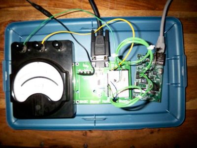

I totally tried to bite radiorental's style and use an analog gauge like his really cool analog network meter instructable.
I purchased a neat looking gauge off of ebay but it required more amps than the stamp could deliver so I grabbed the LCD and think it worked out ok. You can see the analog prototype below.
