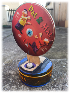

Introduction: STIRLING ENGINE for Every One!
Instructions for building a simple Stirling engine. Suitable for everyone! A few ordinary objects are enough. A little skill, patience and a little time.

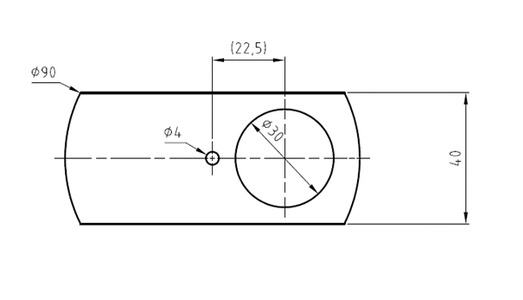

Step 2: Holes in the Can
Now we move on to the manufacture of the working chamber of the engine, in our case, the can. Here, you first need to rinse and clean any dirt. Next, we take the lid of the can and attach the printout of the base (part 1) to it, so that it is centered and outline it completely. So we should see the outline of the base, a circle with a diameter of 30 mm and a center point on the lid.
Now comes the drill. The center point needs to be drilled with a 4 mm diameter drill bit. It is ideal to make a small hole in the point so that the drill does not move and does not press on the drill, and then also a few holes inside the large circle. Now take the sheet metal scissors in your hands and carefully, using the tip of the scissors, cut the entire circle so that there is an opening with an approximate diameter of 30 mm and both holes in the lid line up with part 1.
Step 3: Gluing the Base
When the previous step was successful, we can proceed further. For the actual gluing of part 1, the lid of the can. Both glued surfaces (bottom of part 1, lid of the can) must be roughened with sandpaper (thickness is not important). This will ensure a better adhesion of the glue.
 Apply a sufficient layer of super glue to the tin lid and then attach part one so that the two holes line up and tighten properly so that the joint is perfectly tight. This is absolutely critical to the entire functionality of the engine, as even a small leak will cause it to malfunction.

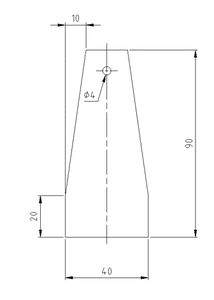

Step 4: Cutting and Pasting the Second Part
We proceed further, to part number two. This part can either be printed, or it needs to be redrawn on the selected material (plywood or plastic board with a thickness of 3 mm), cut out with a saw, grind the edges and then drill a hole for the bearing.
We just glue this manufactured or printed part to the appropriate place, before roughing both glued surfaces again using sandpaper. Glue using instant glue.

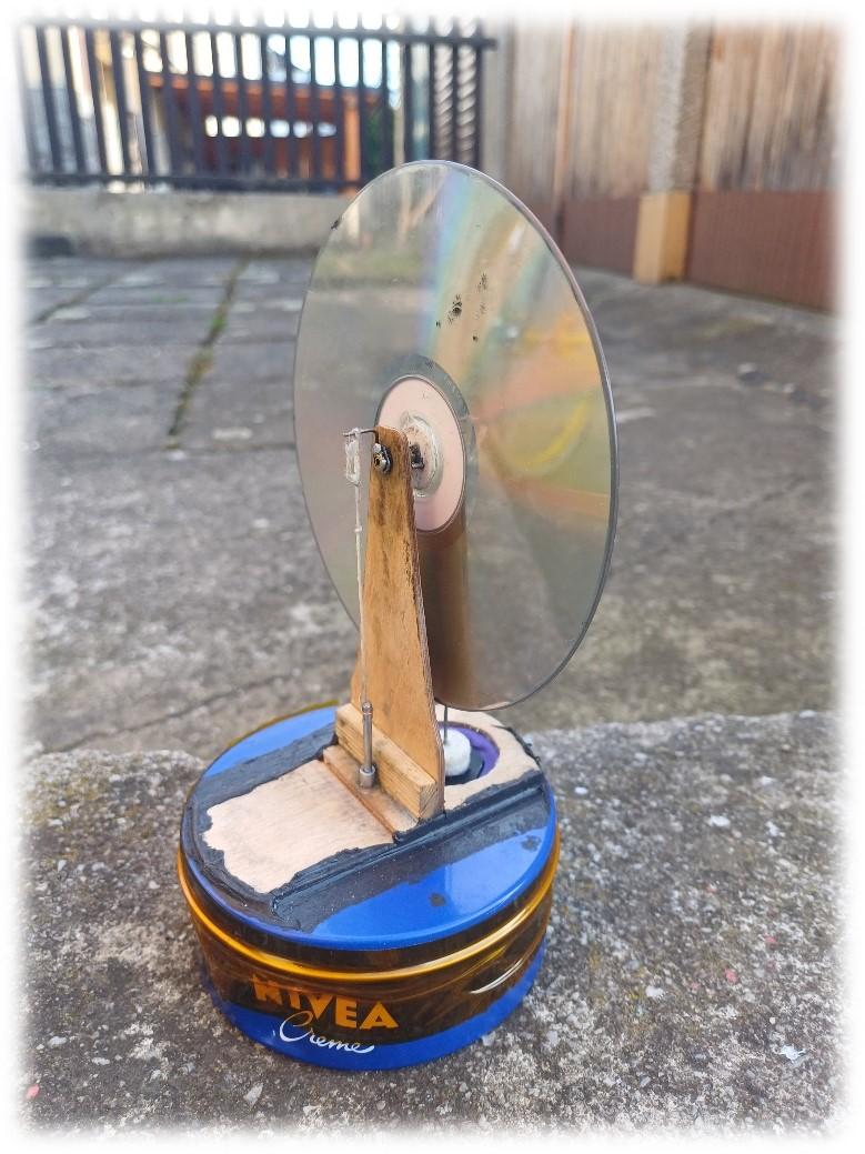

Step 6: Flywheel
Next is the first moving part. We stick our CD into the printed part No. 3 with the help of super glue, making sure that it is attached really well and firmly. Next, we enlarge the central hole with a 2.5 mm drill bit and stick our axis into this hole so that one side is aligned with the edge of the flywheel. All that remains is to enlarge the hole for the first handle with a drill with a diameter of 1.5 mm and insert (do not glue) a shortened small nail into it.
Step 7: Crank
The flywheel and one crank are therefore finished, and we move to the other side of the shaft to the other crank. This is part number 4, which is again easy to assemble. It is necessary to drill the center hole again and again and glue the whole piece to the shaft so that the flywheel rotates, but there is no unnecessary play (a play of around 1 mm is ideal). It is important to make sure that the second handle is turned 90° from the other one. Then pinch the protruding part of the shaft and re-drill a hole into which, as on the other side, glue the shortened nail. Now it is enough to drip the oil so that it flows into the housing and the rotating part is ready.

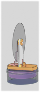

Step 10: Displacer
The last big part is the displacer. We draw three circles with a diameter of 88 mm on cardboard with a thickness of approx. 6 mm, which we then cut out with a knife and glue together, it is possible to use instant glue or ordinary paper glue. In the center of the resulting cylinder, stick a tear rivet with the thick side, and the displacer is ready.
Step 11: Displace Connection
Now all that remains is to connect the displacer to the crank. First, we insert it through the center housing of the lid so that it fits all the way to the lid, and we set the crank to the top dead center (highest position). Now we will take a thread from a length of approx. 120 mm, tie a loop on one side, which will be put on the nail, and glue the other end to the tip of the rivet of the displace using instant glue. Now the displace should move up and down smoothly as you turn the flywheel.

Step 13: Running
Now all that's left is to warm up the engine from the bottom and push it for the first time and then just enjoy the run of the engine you just built yourself! A suitable heat source is any candle or lighter, or even a mug of boiling water, which offers a limited running time. Also, don't forget about safety when handling an open fire, always have water at hand to put out any fire!
