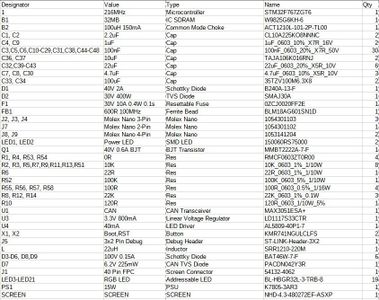

Step 1: Schematic
Review the schematic attached created with Altium Designer. Sanity check all sub-systems and components to ensure no obvious mistakes have been made.

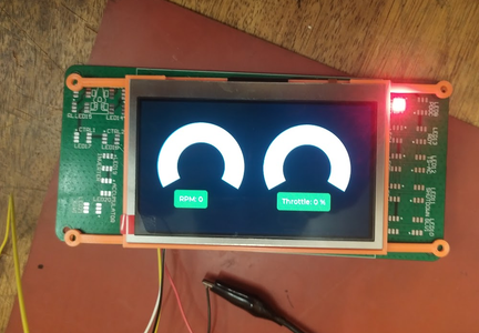

Step 6: Enjoy and Develop Your STM32 Based FSAE Dashboard!
With the completed dashboard, it's time to get an STLINK and connect it to the debug header of the board. It is recommended to use a graphics library such as LVGL to program the board. Thank you to JLCPCB for sponsoring the FSAE47 team!
