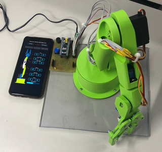

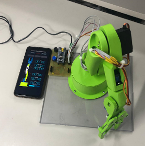

Robot arm project with 6 servo motors wirelessly controlled via Bluetooth developed using STM32 and ESP32 microcontroller. 3 MG995 and 3 SG90 motors are used. It is a simple bluetooth control application developed with MIT AppInvertor. We can give the desired motor the movement we want.

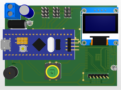

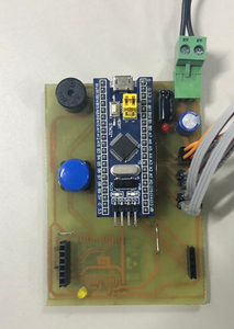

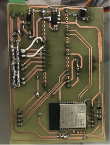

Step 1: PROJECT PCB AND EXPLANATION
HOW TO WORKING:
In this project, the STM32 microcontroller receives commands from the ESP32 Bluetooth module and transmits motion commands to the servo motors. The servo motors connected to each joint of the robot arm are programmed to move at certain angles using PWM with the TIMER channel. The user can control the robot arm via the mobile application.
Software Development In the software part, the firmware developed for STM32 focuses on Bluetooth communication and servo motor control. The main topics are as follows:
  1. - Receiving data via Bluetooth
  2. - Interpretation of incoming data
  3. - Controlling servo motors with PWM signal
  4. - Integration with user interface

Step 3: Bluetooth Robot Control App Developed With App Inventor
This application, developed using App Inventor, provides a simple and user-friendly interface for controlling your robot via Bluetooth.
