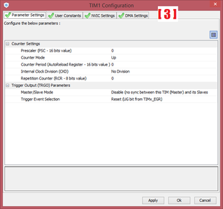

Now, Switch to Configuration Tab. There under ‘Controls’ you will see a ‘TIM1’ Button. Click on that and you will see a window like this:
[3]

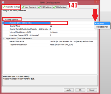

Now, in this “Parameter Settings” tab (already selected) under counter settings Select ‘Prescaler (PSC – 16 bits value)’. And in front of that you will see a drop down arrow (at a place indicated by red arrow in following figure), Click on that. Make sure that “Decimal” is selected. And Change its value from ‘0’ to ‘64000’.
[4]
