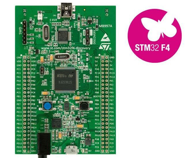

In terms of hardware you need:
- STM32F4 Discovery Board (or any other STM32 board)
- USB to TTL converter

First let's understand what we want to do. We want to transmit data to board from Python over USART and check if we have correct data and toggle led. So, we need enable USART and Led.
- Enable USART2 from Connectivity tab.
- Change mode to Asynchoronous
- Baud rate to 9600 Bits/s
- Word length to 8 Bits without parity
- No parity bit
- From DMA settings add USART2_RX in cicular mode
- From NVIC Settings enable USART2 global interrupt
- Enable LED by clicking on PD12
Then generate code :)
