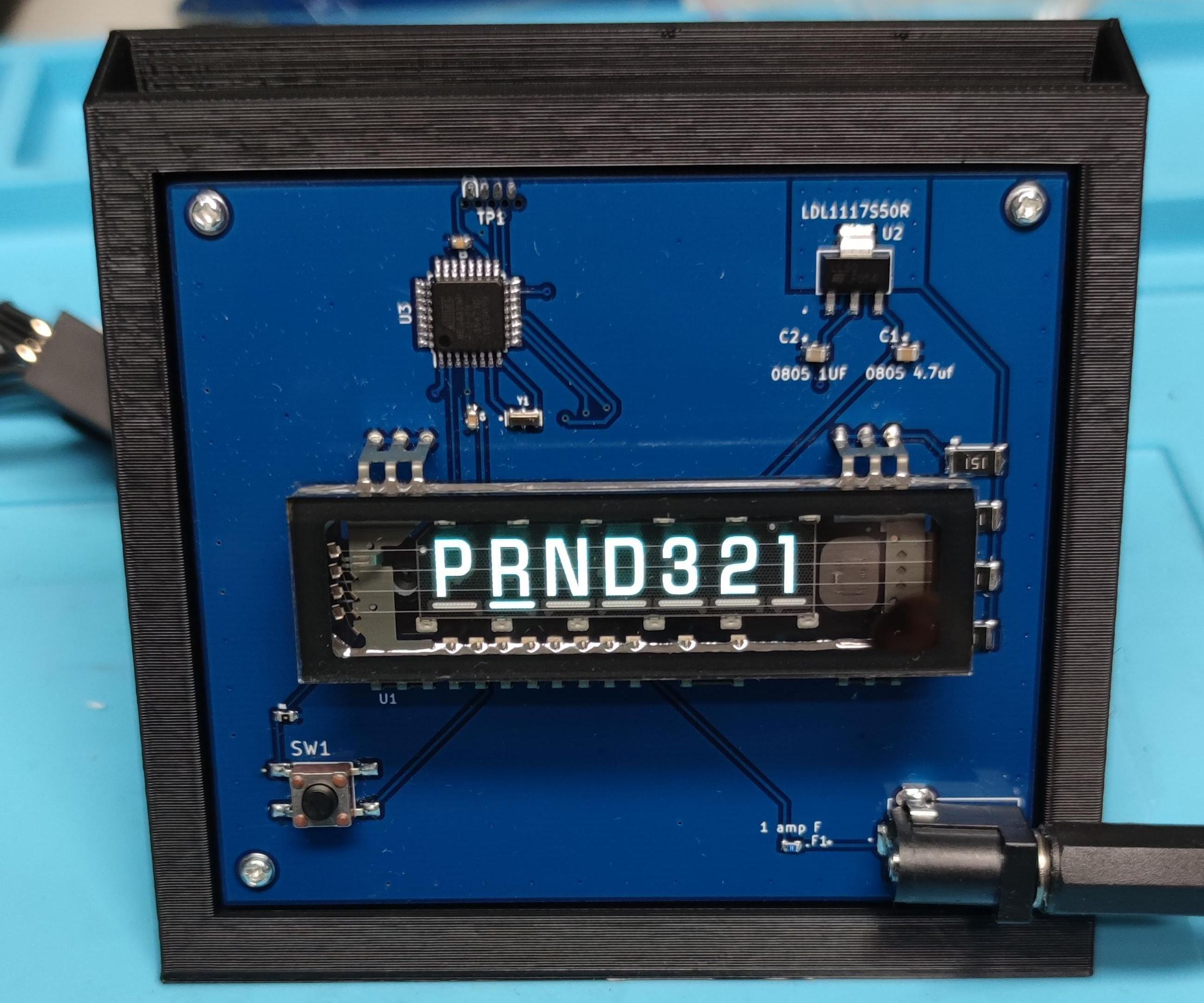

Step 3: Design a PCB for It!
Follow the youtube channel Fixed Until Broken to see how I designed this.
Good new is this a very simple to do yourself in Kicad or if you have no experience designing PCBs EasyEDA might be a better fit. If you don't want use the Bluepill and just want to use STM32F103 or you just want to use the dvr8833 and not the module/breakout board than download the schematics for these to use to help you design your board.
Just don't forget to put Pin 3 / pin 6 of your DRV8833 to ground. ( That is the mistake I made in my design). It was easy to overcome my mistake but scraping off some solder mask and running a jump/bodge wire.
