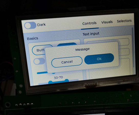

Step 2: STONE STVC080WT-01 LCD Display
8-inch Smart TFT-LCD (Thin Film Transistor - Liquid Crystal Display) Industrial Display Module
STONE STVC080WT-01
The smart TFT LCD module with Cortex-M4 32-bit CPU can be controlled by any MCU through the UART port with simple hexagonal commands.
STONE provides engineers with TOOLBOX software to easily and intuitively set up various functions on the GUI such as text, numbers, curves, image switching, keyboard, progress bar, sliders, dialing, clock and touch buttons, data storage, USB download, video, and audio.
Engineers can easily adopt the TFT-LCD color user interface and touch functionality on a variety of industrial devices while reducing significant development time and costs.
Easy to use:
1. Design a beautiful "graphical user interface" and set up various application functions on the GUI using our toolbox software.
2. Connect directly to customer MCUs via RS232, RS485, or TTL level, plug and play. 3.
3. Write an MCU program to control the TFT LCD module using 4 simple hex commands.
For example, the image switches command:
Send "0xA5 0x5A 0x04 0x80 0x03 0x00 0x01" to display image-01
0xA50x5A: frame title of each command
0x04: Data length
0x80: Write registration instructions
0x03: Image switch instruction
0x000x01: Image_ID, the serial number of the image storage location
Application areas: medical beauty equipment, construction machinery and vehicle equipment, electronic instruments, industrial control systems, power industry, civil electronic equipment, automation equipment, transportation equipment, etc.
Product advantages
1. Touch terminal, thin-film transistor LCD system.
2. Any microcontroller can be controlled by a simple instruction set.
3. Cost-effective HMI (Human Machine Touch Terminal).
Operation steps
1. Design a set of custom user interfaces.
2. Connect the device to the TFT-LCD module via RS232/RS485/TTL serial port.
3. Write a control program in any microcontroller containing the instruction set to control the TFT-LCD module (included in the product).
Auxiliary Software
We provide three software programs to help the operation of the TFT-LCD module.
1. Assistant software: Used to upload pictures, files, and demo instruction sets.
2. Touch Control Software: for generating touch control files.
3. Font software: for generating font files.
Working Principle
With the existing command set provided by the product, this TFT-LCD module can generate command transmission and recognition using the master controller. The master controller receives commands from the TFT-LCD module to operate the industrial device.
Note: The engineer can use any microcontroller to design the master controller.

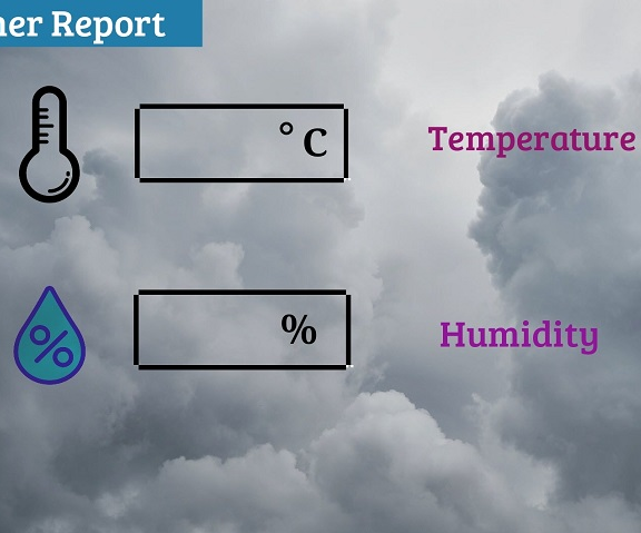

Step 5: GUI Using Tool Software 4.3 Tool Editing Page
Import the prepared jpg image into the software
Step 6: STONE TFT LCD + STM32 + Servo Head Effect Picture
We just need to connect the STM32 board, the servo head, the display and the power supply. Drag the progress bar at the top of the STONE display to control the activity of the servo head.
