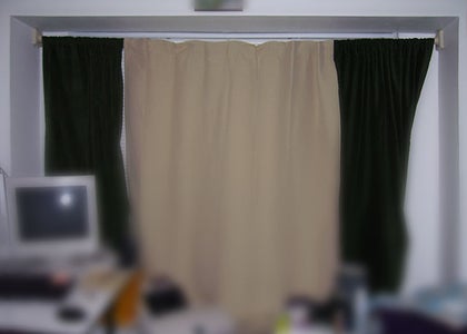

Step 2: Assemble and Paint Rod Holders
Prime the post cap then glue the door stop on it.
Paint with desired color.
Apply 3M Command strips at the back. Follow 3M instructions.
Place 2 for extra strength due to the length of the curtain rod and weight of the drapes.
The instructions also come with weight restrictions.
If I was really paranoid I'd place 3 but the drapes held up and didn't fall down at all.
Despite the strips sticking out for easy removal, it wasn't so bad because the drapes covered them.
Step 3: Placing the Rod Holders Unto Wall
Followed the 3M directions and placed the holders into position.
Waited at least an hour before putting up the spring tension rod and drapes.
The spring tension rod fit perfectly into the wall door stop.
The combination of the spring in the rod and the door stop fitting probably helped stabilize
the window drapery even further.
