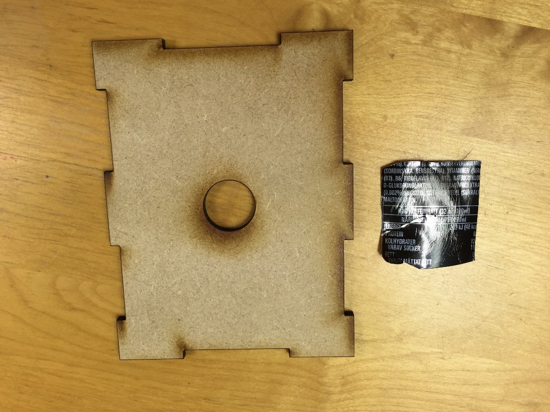

Step 3: Cut the Aluminum Beer/soda Can
Now it´s time to prepare the aluminum plate. Cut out a 2x2 cm square piece from the beer/soda can with your scissor.
Step 4: Drilling the Hole
Use the pin needle to drill through your piece of aluminum. Do this by turning the needle round and round until you get through.
Step 5: Sanding the Aluminum Plate
Use the sanding paper to smooth the hole on the opposite side of the aluminum plate.
Step 6: Find the Centre Piece

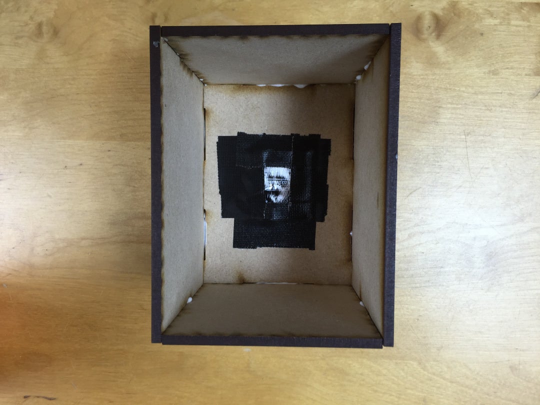

Find the centre piece of the outer box. Attach your aluminum plate with pieces of black tape. Control that your pinhole is centred.
Step 7: Starting the Assembly
Now it´s time to start the assembly of the outer box of the camera. Start by selecting the centre piece with your aluminum plate and one of the longer side pieces. Now use your wood glue to mount the pieces together. Make sure not to use to much glue.
Step 8: Continue the Assembly
Continue the assembly of the outer piece of the camera. Use wood glue to mount the different side pieces together as you did in the previous step.
Step 9: Prevent Light Leakage
Time to prevent unwanted light to leak into our camera. Use black pieces of tape on the outside corners and sides of the assembled outer camera box.
