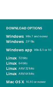

- Download and install Arduino IDE. LINK

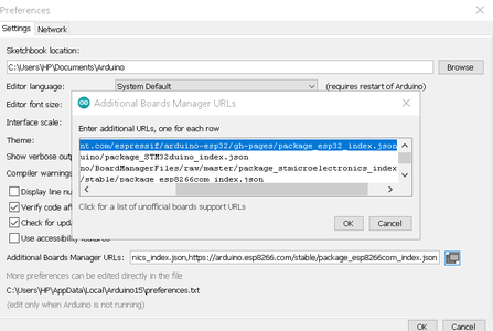

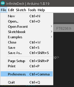

- Select File > Preferences.
- Copy the next text and paste it in the Additional Boards Manager URL:
https://raw.githubusercontent.com/espressif/arduino-esp32/gh-pages/package_esp32_index.json

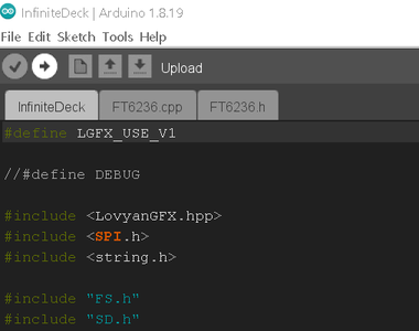

- Note: Make sure these 2 files with the InfiniteDeck.ino file are in the same folder.

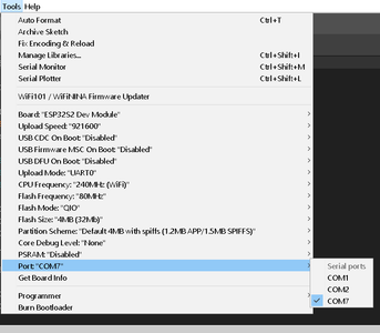

- once all this is set up you can Open the InfiniteDeck.ino file and Select the correct board with Tools > Boards: .... > ESP32 Arduino and find the ESP32S2 Dev Module.
- Run the compiler, click on "Verify" check mark on the left of the top menu bar.
- Then connect your board using an USB Cable, the software will detect the device as a COM Port.
- Then click in the Upload Button (The right-arrow next to the Verify/Compile check mark button).
- Done!.
Note: If you have more than one serial device connected your PC, you need to select the right COM Port, to detect the COM Port you can enter the Device Manager and look for Ports (COM & LPT). You can plug and unplug the board and check which COM Port appears and disappears.
