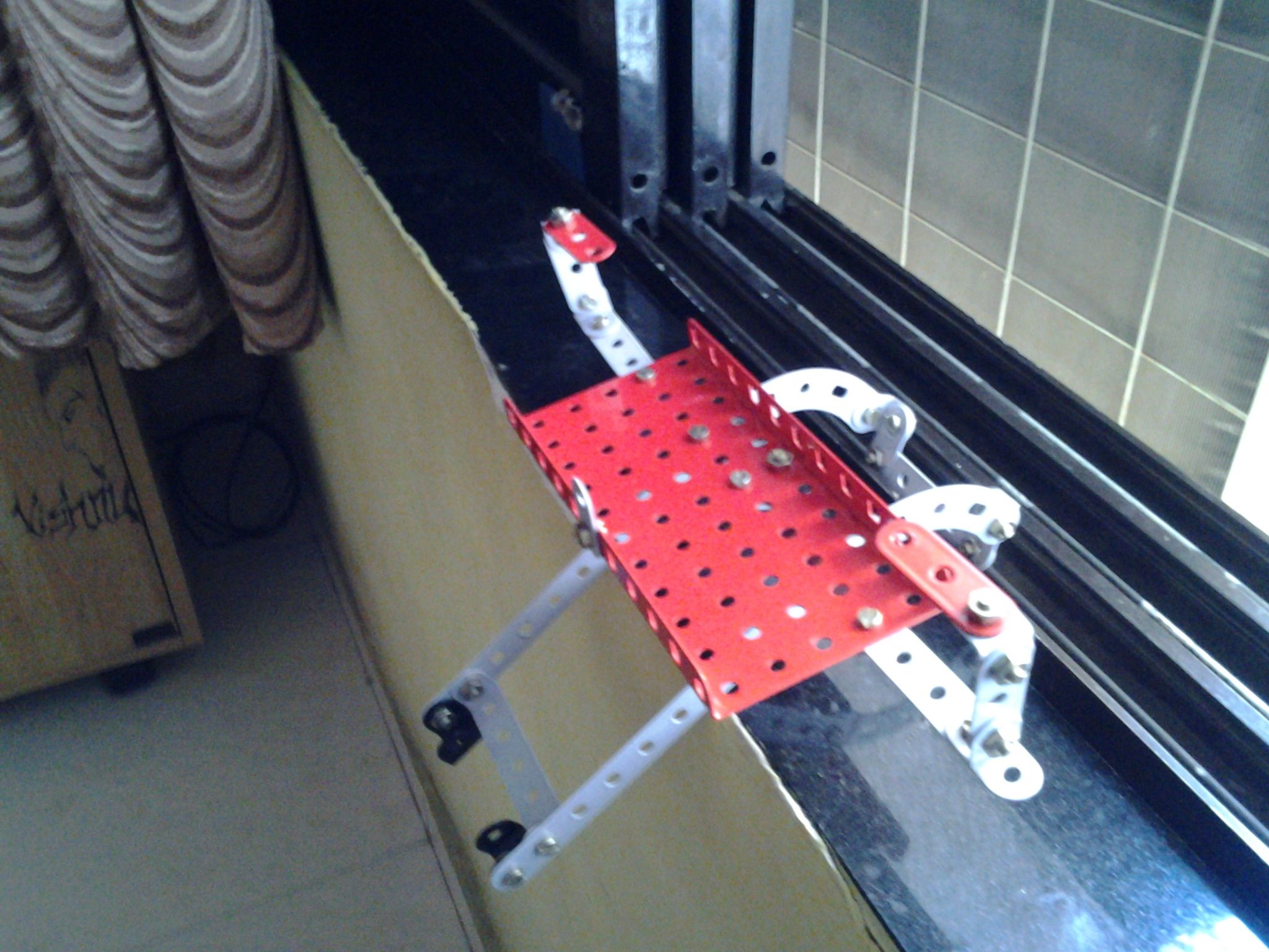

Step 4: SETUP OF LAMP ARMS
1. I took 2 normal wooden stick ,drill it at 2 ends and connected it with screws and MECHANIX parts.
2. to connect lamp head wtih arm,take 1 a-5,1 ab-3,2 ab-5 and 1 ab-2(see the pics of step 1) and join it as shown in fig 1. Drill the lamp head at the tapering end so that a-5 could be bolted .
3. To connect 2 wooden stick,take 2 a-7,1 ab-3 ,1 bigger bolt and join it as shown in fig 2.
4. To connect the base to the wall take 3 bt-5,1 ab-3,1a-11,1 ab-2.
5. Drill 3 holes onto the wall vertically at a distance of 3 cm in between.
6. Join the base as shown in fig 3.
