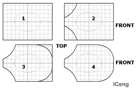

Step 5: CUT the OUTSIDE HEAD SHAPE
For this step I used a wood frame laying around my shop.
FRAME TOOL ;
  • Drill a hole 8" from one side top and bottom to slide the wire through.
  • Attach the split bolt wire connectors top and bottom.
  • You have to expect to set the variac to a higher 50 dial setting.
  • Here is a video by the Captain of Light.
And one more video by the Captain of Light
shows the pretty green variac and the smoke collecting up in the ceiling.

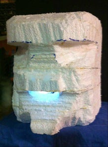

Step 6: CARVE THE FACE
Use the FRAME TOOL
  • To cut the TOP shapes outlined in [ picture 2 ].
  • Lay the mask on its side.
  • Cut the SIDE shapes outlined in [ picture 3 ].
Use the KNIFE TOOL # 3
To cut the EYE slots [ see pictures 5 thru 9 ].
INSTALL LED STRIP ;
  • Referring to the [ last four pictures ].
  • The blue LED strip glue side is pressed against the top eye slot.
  • But first the LED strip is passed through the nose bridge.
  • Run the wires over the top of the helmet using a hanger wire.

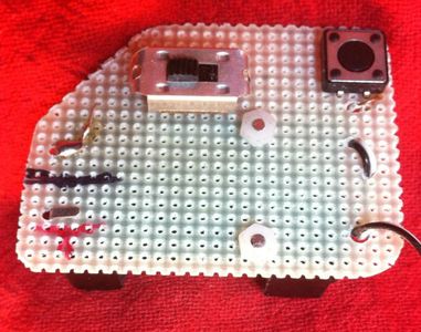

Step 7: LED DRIVER HAND CONTROL
Making the Simple HAND CONTROL ;
Don't Panic, there are only four or five components on the HAND CONTROL.
The Hand Control uses a 9volt battery and has two switches and one diode [ see picture 1 ].
The slide switch turns the LEDs ON / off.
The push button makes the LEDs get Emotionally BRIGHTER when pushed !
See how it works.....
You can use cheep battery snap wire clips and cardboard in place of the fiberglass I used.
Any switches will work and tape and rubber bands will hold things together.
use low cost speaker wire for the LEDs.
TIP don't keep loose change in the same pocket as the Hand Control.
TIP don't use spray paint as it actually devolves the styrofoam.
