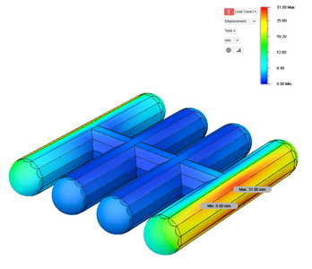

So, to test if the structure can survive at 500m depths, we can use the power of FEA simulation. By applying a pressure of 727.8 psi to the outer faces of our model, we will simulate the conditions at the bottom of the coastal ocean.
Luckily, Fusion has a built-in hydrostatic pressure simulator! To verify our mathematics with the actual simulation, I ran 2 simulations on the same model (shown in the images). One was a hydrostatic seawater simulation, with the surface of the ocean 500m above, and the other was a regular pressure simulation with our hand-calculated pressure of 730 psi.
Our displacement figures were within 200mm of each other! How cool is that?!
(Don't worry about the excessive deformation, this was an intentional overstressing of the geometry for testing)
For the rest of the simulations, I'll use the built-in hydrostatic simulation function for convenience, as we've shown we get reasonably close results.

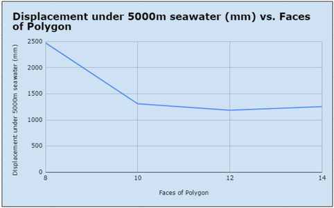

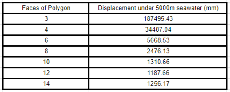

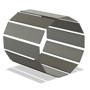

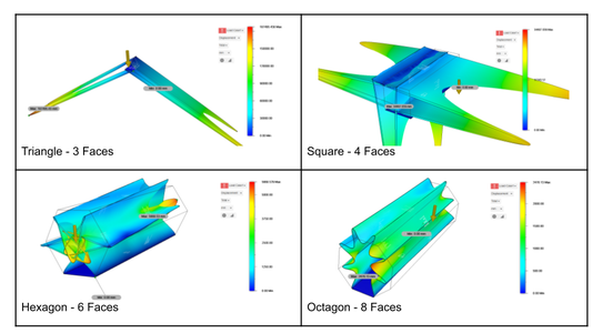

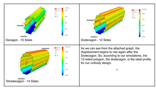

Step 4: Evaluating Cross-Sectional Shape of Design
(This section was conducted through a bit of intuition and just going along with things, I have no formal engineering education yet. Results may be very off)
Having chosen the unibody modular design, we need to then figure out what shape we will be using for the cross-section. A variety of shapes can all be used, with different strengths and weaknesses, but there is no way to know without simulation.
To test the viability of various polygons, a solid model was made in Fusion of each shape.
  • Each shape was a circumscribed polygon with a radius of 120"
  • This polygon was offset outward a distance of 1"
  • This was extruded to a length of 720"
For FEA Setup:
  • The bottom face of each polygon was constrained
  • Since this will be the face resting on the seafloor, I believe it is realistic to assume it will be relatively stationary.
  • A Hydrostatic Pressure Load was applied to all other outer faces of the polygon, with the surface of the ocean being set to 500m above (this simulates the structure lying on the ocean floor 500m down).
  • The model was meshed and results computed.

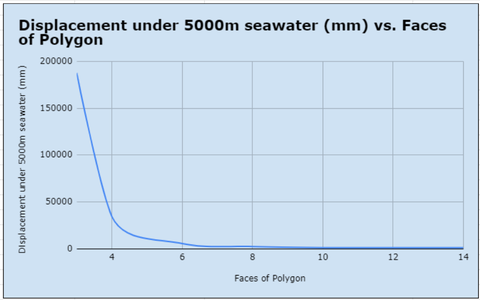

Results:
  • Here we are looking for minimal displacement. The less a shape deforms, the stronger we can assume it to be. So, lower numbers are better.
  • The triangle and square just fall apart hilariously, but from then on, the strength increases with more sides added to the shape. However, the displacement reaches its lowest at the 12-sided dodecagon, then begins to increase after.
Theory as to why:
  • The pressure is a constant at these depths. So, the fewer faces these shapes have, the more share of the pressure each face has to take. I believe this is why the triangle and square deform so much. The 2 applicable faces of the triangle (the 3rd is constrained) each have to bear 1/2 of that pressure. And with the square, 1/3. This trend continues and is why the octagon behaves better than the hexagon (1/7 of the pressure, so less load, as opposed to the hexagon's 1/5.)
  • This trend peaks at 12 faces, but then displacement increases afterward. Why?
  • My working theory is that at that point, the shape becomes too flimsy and does not have enough structure in itself to stay together. This is very rough and unbased, so I would love to see some professional analysis on this.
So:
  • The 12-sided unibody is the design that had the least displacement, so we will choose to go with that as our profile.

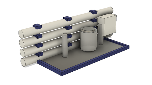

Step 10: Life Support
These are some mockups of the air, desalination, and hydroponics systems in a Light Configuration habitat.
  • The gas cylinders can be stored under the floor. Because our shape is cylindrical in nature, adding a flat floor eliminates some space from the overall room. However, this underfloor area can be used as storage space.
  • These are modeled and rendered locally in Fusion.
