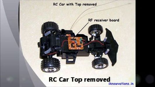

Step 2: Understanding How Rc Car Works
We will assume that the exact frequency used is 27.9 MHz. Here's the sequence of events that take place when you use the RC transmitter: You press a trigger to make the truck go forward.The trigger causes a pair of electrical contacts to touch, completing a circuit connected to a specific pin of an integrated circuit (IC).The completed circuit causes the transmitter to transmit a set sequence of electrical pulses (see How Radio Works for details). Each sequence contains a short group of synchronization pulses, followed by the pulse sequence. For our truck, the synchronization segment ,which alerts the receiver to incoming information ,is four pulses that are 2.1 milliseconds (thousandths of a second) long, with 700-microsecond (millionths of a second) intervals. The pulse segment, which tells the antenna what the new information is, uses 700-microsecond pulses with 700-microsecond intervals.
Inside our RC car, we have two electric motors, an antenna, a battery pack and a circuit board.
One motor turns the front wheel right or left, while the other motor turns the rear wheels to go forward or backward. The circuit board contains the IC chip, amplifier and radio receiver. A few simple gears connect the motors to the wheels. It is really amazing how versatile the range of movement is with so few components.
I will also show you a typical rc car pic

Step 4: Open Your Rc Car
WARNING:YOU MIGHT LOSE THE RC CAR ability forever
Open all the screws from the rc car and take only the important parts shown in the pic.
Don't forget to remember/take a pic of the circuit(except if you know what goes to what)or you might make your plane go crazy.

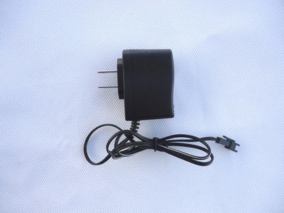

Step 10: Home Made Lipo Charger
I used an old heli charger and cut the cables.There will be 2 cables inside.a ground cable and a 5v cable.You will need to split and skin the cables.
You can charge you're lipo by just connecting
Lipo - charger
Red(5v)-Red(5v)
Black(ground)-black(ground)
Sometimes the ground cable can be in different colours including green and brown.
