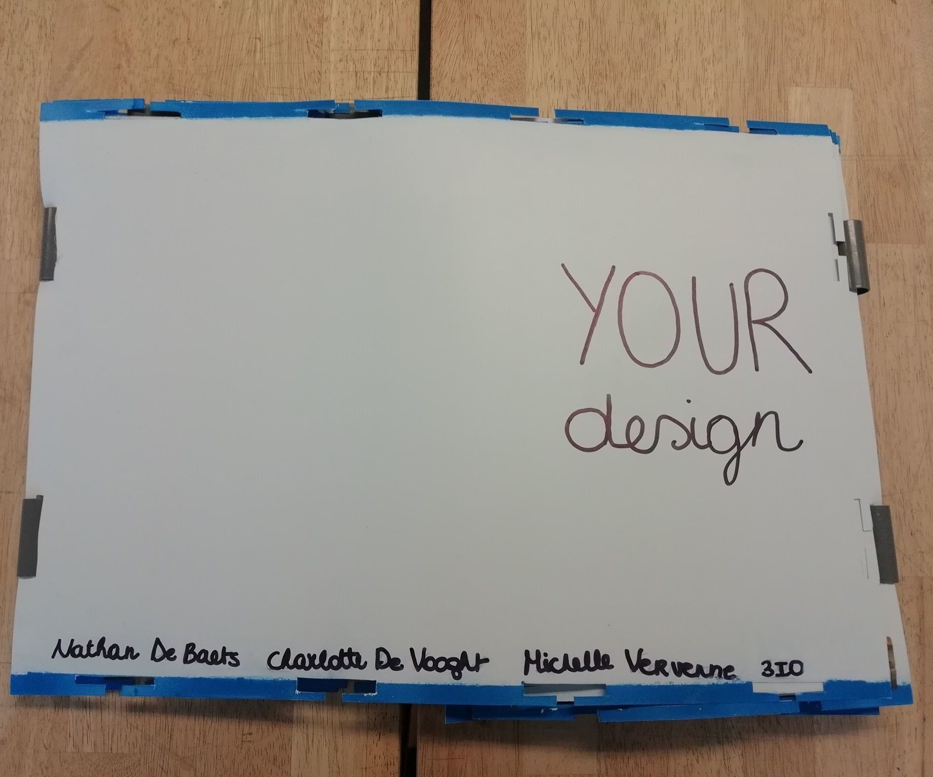

Step 1: Lasercut the Grid
I made the grid in CAD Siemens nx, and I lasercutted this via Adobe illustrator.
The material is abs.
Step 2: Thermoform the Basic Parts
There are 3 basic parts.
First I made foam models in PUR (polyurethane) , then I thermoformed these from PS sheets (polystyrene).
After thermoforming, I cut the holes for the eyes with a cutter knife and made a hole on each side of the thermoform. You can look at the video to see where exactly and why.
Step 3: Make the Extra Parts
You lasercut some new parts that fit into the holes of the grid that you also lasercut.
On the end of these pieces, glue (with superglue) the circles that you cut out earlier to the part.
You can make the extra parts by glueing them onto the circles. I made feet that I cut out of foam.
Step 4: Make It Your SWAP
Watch the video to see what you have to do to make your own SWAP.
