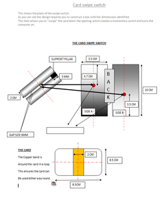

The connections to the switch are on side A and side B where wires are attached to provide the contacts to the computer motherboard.
Just swipe the card down the slot and it creates a momentary switch; This is enough to start the computer.
There is a detailed drawing of the dimensions, in the picture you can see the measurements and orientation of the contacts.
I have found that brass split pins work best as the contacts they are smooth and resilient.
also some shots of the prototype being constructed.
