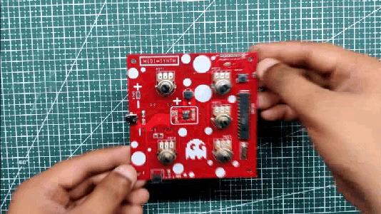

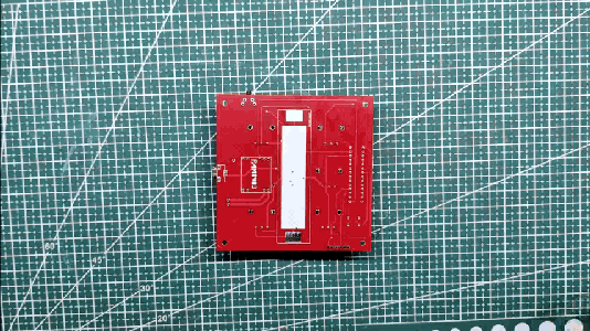

Step 2: PCB Design
In order to create the PCB design for this project, a simple Atmega328PU setup is first created. This setup consists of an Atmega328PU connected to a 10K resistor with a reset pin and a resonator circuit composed of two 22 pF capacitors connected to a 16 mHz crystal oscillator.
This circuit also includes a PAM8403 amplifier, which is used to power the 4 ohm speaker.
The 3.7V of the lithium cell is increased to a stable 5V for powering the Atmega configuration in this setup using the power management IC, the IP5303 IC.
We export the netlist and prepare the board in the PCB Editor after configuring the schematic.
The PCB editing procedure includes creating a 95x95mm outline, arranging the pots, power management IC, and atmega setup on it, and connecting them.

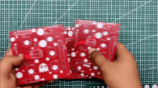

Step 3: SEEED FUSION PCB SERVICE
After finalizing the PCB and generating its Gerber data, I send it to SEEED STUDIO for samples.
I ordered PCBs in red Solder mask with white silkscreen.
PCBs were received in a week, and their quality was super good considering the rate, which was also pretty low.
Seeed Fusion PCB Service offers one-stop prototyping for PCB manufacture and PCB assembly, and as a result, they produce superior quality PCBs and Fast turnkey PCBA within 7 working days.
PCB Quality of this MIDI BOX PCB WAS SUPER!
Seeed Studio Fusion PCB Assembly Service takes care of the entire fabrication process from Seeed Studio Fusion PCB Assembly Service takes care of the entire fabrication process from Seeed Studio Fusion Agile manufacturing and hardware customization, parts sourcing, assembly, and testing services, so you can be sure that they are getting a quality product.
After gauging market interest and verifying a working prototype, Seeed Propagate Service can help you bring the product to market with professional guidance and a strong network of connections.

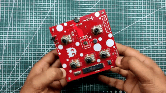

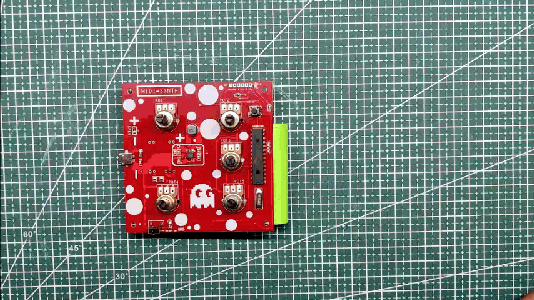

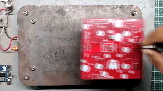

Step 4: PCB Assembly

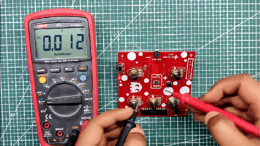

Two main parts make up the PCB assembly procedure for this project: first, we add SMD components, and then we insert THT components.
  • We begin by applying solder paste to each component pad individually using a solder paste dispensing syringe.
  • Next, we pick and place all the components in their proper places using ESD tweezers.
  • Following the pick and place process, we place this board on a mini reflow hotplate, which heats the PCB from the bottom up to the solder paste melting temperature.
  • The USB port, potentiometers, and Atmega328PU are then placed in their correct locations together with the rest of the THT component
  • After using a soldering iron to connect their pads, we add a lithium battery holder to the circuit's bottom side.
  • The circuit is now fully assembled.

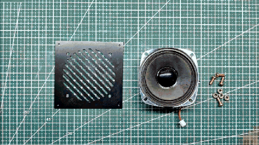

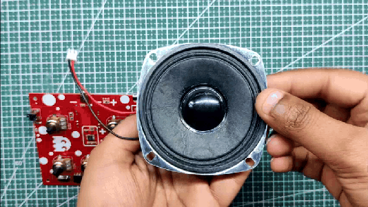

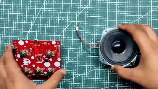

Step 8: SPEAKER
It was decided to use a generic 4 ohm speaker as the main driver because it was adequate for this project. It is possible to add speakers that produce much higher tones, but doing so would necessitate the addition of a power amplifier. While this is technically possible, it is not advised because it will result in a variety of sounds with various pitches and frequencies. Do this only if you despise your neighbors.
We connect a 1uF capacitor in series with the output I/O port's positive terminal.
Adding a 1uF electrolytic capacitor in series with a speaker serves as a DC blocking mechanism. It prevents any direct current (DC) component present in the audio signal from reaching the speaker. This helps protect the speaker from potential damage that could occur if a DC offset were to drive the speaker cone to one extreme and keep it there. By blocking the DC component, only the alternating current (AC) audio signal is allowed to pass through and produce sound from the speaker.

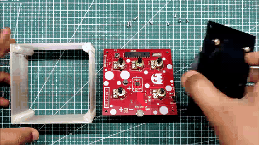

Step 9: Main Assembly
  • Four M3 nuts and bolts are used to attach the speaker to the 3D-printed speaker grill as the first step in the main assembly.
  • Next, using four M2 screws, we attach the speaker grill assembly to one side of the 3D-printed base.
  • The assembly is then finished by attaching the main circuit to the bottom side of the mid body assembly using the same M2 screws.
Step 10: RESULT
The outcome of this straightforward construction is a functional but odd-sounding MIDI synthesizer that can produce a variety of sci-fi sounds, including cat meowing, R2D2 beeping, and other sounds of a like sort.
