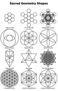

Step 1: Finding a Suitable Geometry
There are lots of "sacred" geometry shapes which can be used as baseplate of a clock. First, we make a simple google search for sacred geometry and find some images which can fit our design needs. I had chosen the "vector equilibrium" for this project. We also need a clock image for comparison. To choose the correct geometry for our needs, we need to use a 3D CAD program. We can use other 3D CAD programs for our purpose but the simplest and most powerful tool I used is Fusion360. So, for designing with ease, we will stick with Fusion360.
