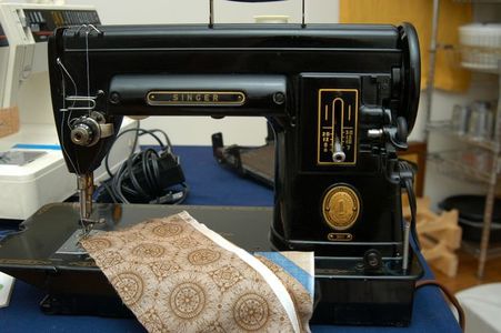

You may think, "not this old Singer, it's indestructible!" but the fact that it is so heavy and sturdy also makes it vulnerable when shipping. It can bust out of its confines, becoming susceptible to dings, dents crack and worse. I'm displaying a 1956 Singer 301 and a ton of accessories for this demo, but you can modify to suit any machine, obviously. Just note your trouble areas and deal with them accordingly.

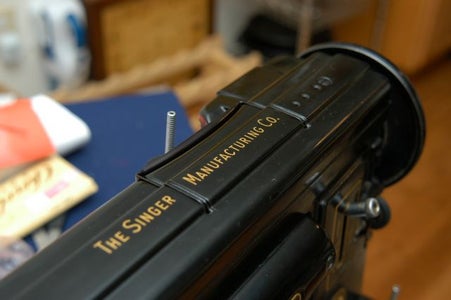

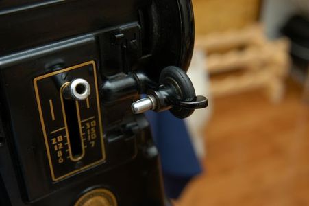

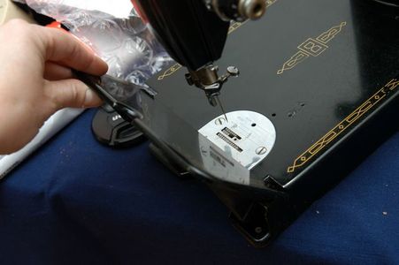

Step 2: Deal With "problem Areas" First.
Drop bobbin winder or tuck in in as close to the body of the machine as possible.
In some models (the 221 Featherweights especially) it is recommended that you actually remove the entire bobbin winder as it is most likely to break off in transit.
In many models it is safer to remove the presser foot before shipping.
If there is a carry handle, make sure it is folded in.
Flip up folding bed (if there is one) and add padding where needed.
Basically, get the machine as small and compact as it will go. This may mean removing a few extremities. Again, in the 221 you will also want to remove the top that holds the thread spool.

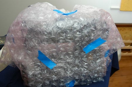

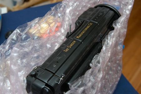

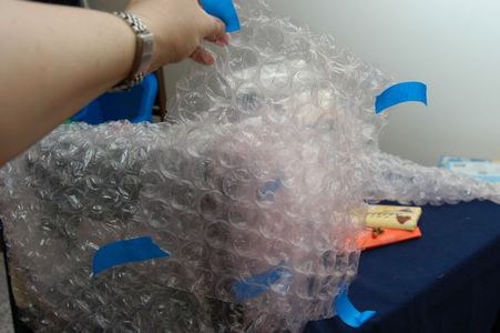

Step 3: Start Bubble-wrapping!
If you are reusing old bubble wrap and only have small pieces you can tape them together, so long as they surround the machine several times, covering ALL surfaces, and paying close attention to all corners and other protrusions.

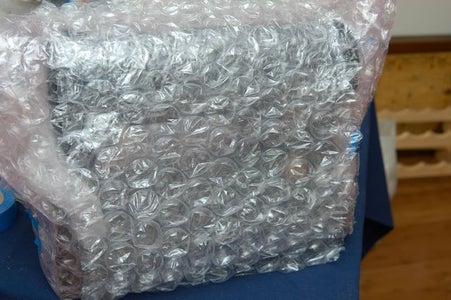

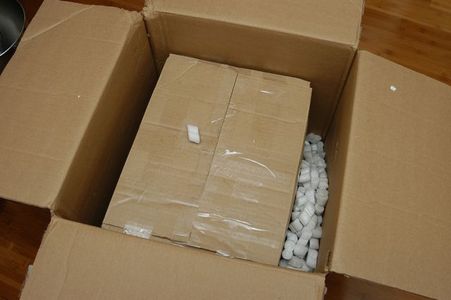

Step 4: Pack the First (or Inner) Box.
Put the puffy bubble-wrapped machine in a box as close to snug as you can, and fill the box with extra bubble wrap or peanuts if there is ANY room for it to shift. Tape it up securely on all sides.

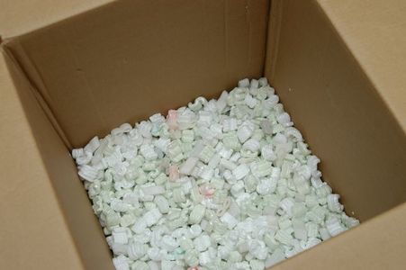

Step 5: Prepare the Second (outer) Box.
Fill only the bottom of the second larger box with Styrofoam peanuts about 6 -8 inches (it will compress a bit).
Step 6: Nest Inner Box Inside Outer Box.
Now carefully position the first box the center of the outer box and fill the sides with more peanuts. REALLY pack them in, as much as you can.

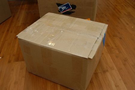

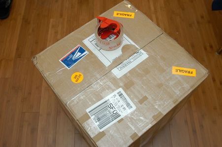

Step 8: Top It Off and Close It Up!
Now pour Styrofoam peanuts over the whole thing, making sure they get in between all the small items and really pack those edges full! Make it so there is a slight mound on top so when you close the box you have to hold it down to keep it closed. This will ensure it is all nice and snug and nothing will shift in transit. Tape it up nice and strong on all sides, label it, and it's ready to go!
