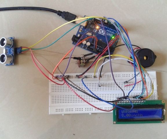

Step 3: The Connection Business
Please hold on to your seats and put your seatbelts because you are going for wild ride in the jungle of wires, sensors, and other stuff. Well so what are we waiting for let us start !
Well in this step let us discuss about the connections. You have the positive terminal of the buzzer connected to the digital pin 6. While connecting the LCD you don't want to connect four of the pins. The servo pin is connected to digital pin 10. The IR module's data pin is connected to the digital pin 7. The ultrasonic sensor's trigpin is connected to digital pin 8. The eco pin is connected to the digital pin 7. If you have any trouble look in the diagram above. I do hope it is not confusing.

Well as you can see my connections looks seriously like a jungle. But that doesn't matter as long as it is working and as you are going to put it in a box.

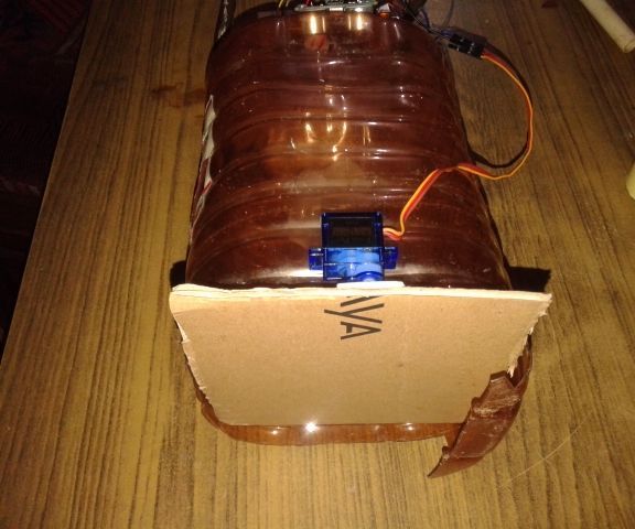

FIND A BOX - Find a box of your convenience but make sure it is strong (well, almost).
THE LOCKING MECHANISM - In the locking mechanism you have a servo which is in 0 degree position.
PLACE YOUR SENSOR - Make a hole for your ultrasonic sensor to come out.
DISPLAY - for the display cut out the right amount cardboard to show the LCD display(make sure no body can put hands in it).
YOUR CARD SLOT - On the top right side of your box (image 4) make a narrow cut gut enough for your card to pass through.
MAKE A HOLE - Make a hole on the right side of your box(image 5 & 6). This is to make sure the IR will detect your card only. If there is no hole then the IR will detect the wall of the box as your card.
PLACE YOUR IR MODULE - Inside the box, place an IR module pointing toward the hole you just made. (image 8)
TAPE THE HOLE - Tape the hole with a black tape(make sure you tape it outside the hole). You should tape it with a black tape. We are using black tape because the IR rays emitted will be absorbed by the black color (yes, yes back to our physics class).so when the card is kept(the card should be of a light color) it will become an obstacle.(image 7).
