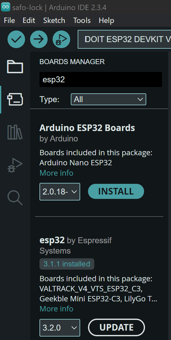

Step 4: Install ESP32 Board in Arduino IDE
You will need to first install the esp32 board in your Arduino IDE.
Therefore follow these steps to do so:
  1. Navigate to File -> Preferences
  2. Add this url in the "Additional Board manager URLs"
  3. Enter this link: https://dl.espressif.com/dl/package_esp32_index.json
  4. press OK
  5. Now go to board manager: You will find it on the left menu.
  6. search "esp32 by Espressif" you will find the result select on INSTALL (Refer to the second image in this step, it is the second result).
  7. In my case it is already installed.

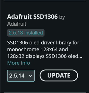

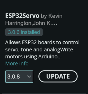

Additionally you will need to download these libraries:
  1. Adafruit SSD1306 (For the OLED)
  2. ESP32 Servo
Refer to the images to search them in the Library Manager.

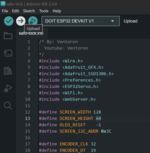

Step 8: Upload the Code
  1. Once you have chosen your board press Upload (Arrow Symbol). It is highlighted in the image.
  2. Now, when it compiles and then starts to upload, you will a connecting ... response in the output.
  3. Here, you have to press and hold "boot" button on the ESP32 when it starts saying connecting.
  4. Hold it till it has uploaded.
  5. Refer to second image to see the compiling stage.
  6. Refer to third image to see the Uploaded stage.

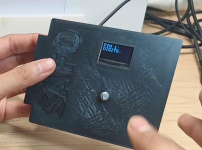

So the first time it displays:
PIN1
DIGITS:
Here's the fun part, the Rotary Encoder or the Dial helps you rotate till the desired number is reached for that particular PIN number. To confirm the number, push the dial (The rotary encoder has a built in switch)

and once they are all matching with the value, the servo motor opens the lock
Refer to the videos second half to see how the locking mechanism works.

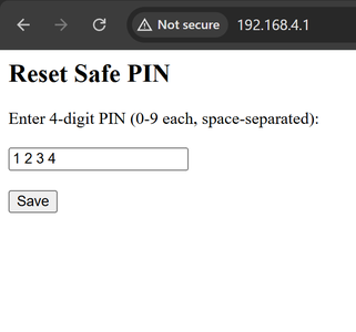

Changing the PIN:
  1. So, using your Smartphone or Laptop, go to your wifi settings.
  2. You will find a network called "ESP_SAFE_LOCK"
  3. Press to connect and enter the password: 12345678
  4. Once it is connected, open a browser and enter the address "192.168.4.1"
  5. You will get an interface as shown in image.
  6. In my case I set it as 1 2 3 4.

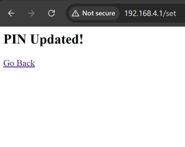

  7. Hit save and you will get a page with "PIN Updated!"
And that's it, the device updates this new PIN and you can verify the same.
