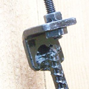

I used an "L"-shaped piece of angle iron for part of the adjustment. The threaded rod passes through a hole in the angle and the adjustment is set with two nuts. The angle is welded to the other piece of reinforcement bar. I probably used heavier, thicker steel than was necessary, but I was not certain how much tension would be needed to pull the 4 x 4 posts back into alignment.

I bolted the two sections of the strut together at the adjustment. I left most of the threaded portion available above the angle so I could tighten the adjustment as much as I want later. Then I mounted the top of the strut. Next I mounted the bottom of the strut. Then I tightened the adjustment until the two parts of the latch aligned for smooth operation.
