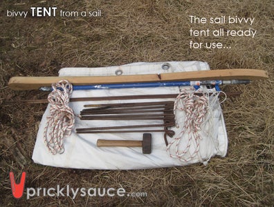

Step 1: Get It Together!
YOU WILL NEED
An old sail, I used a Jib sail, the smaller front one!
10 Metal fencing stakes
Braid on Braid marine rope for splicing, about 12m for the tent guys + 8m for the additional sun shade guys
An adjustable paint roller handle
Bolt + nut to go in the end of the paint roller handle
Waterproofer, I used fabsil universal silicone waterproofer
Strong sewing thread
Ripstop fabric strips
A scrap length of timber
Silicone mastic
Lump hammer for driving in the stakes
Large tough bag for storing
TOOLS
Fid for splicing
Heavy weight sewing needle/machine
Scissors
Angle grinder/hacksaw
Brush
Some general wood working tools

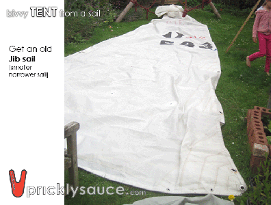

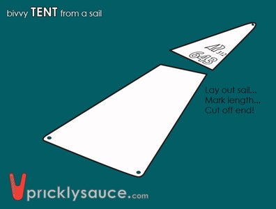

Lay out the sail

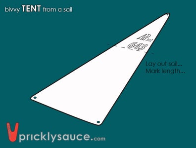

Fold the sail into a tent shape, you may need someone else to hold one side to do this.
The sail I used had some large eyelet holes and I was able to use these for the end pole stakes to poke through
Mark and cut the top section off.

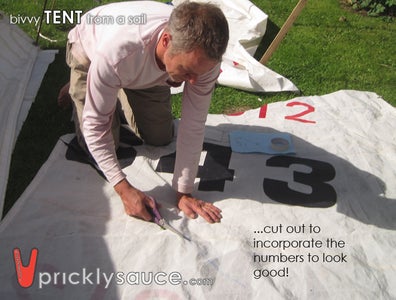

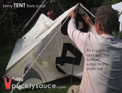

Step 3: The Doors

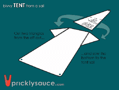

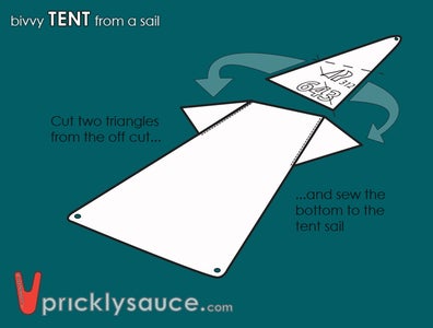

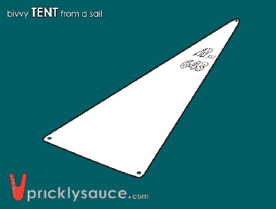

Work out the sizes of the triangular door openings to both ends.
Cut out the two triangles from the off cut sail.
I made sure that they had the sail numbers on them for that cool image.

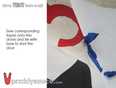

Sew the door triangle to the main tent sail along the bottom edge of the door panel.
Sail cloth is tough and a strong needle and thread is required.

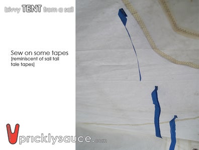

Sew on some ripstop fabric strips up both sides of the doors to tie shut the doors with simple bows, I like the fact that they are like the tail tale tabs from a sail.

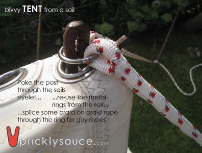

Step 4: Get Some Guys!

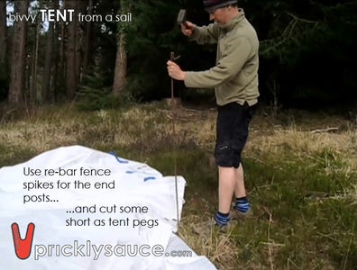

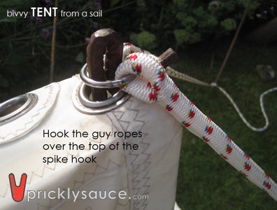

The end poles are metal fence stakes, the tent hooks over the top through the eyelets.
If your tent doesn't have eyelets, then your local chandeliers should have a kit.
Hammer them into the ground to work out the height and mark the distance with a shallow marking cut at ground level. This helps for erecting the tent in the future.
Whilst you have the angle grinder out, cut the rest of the fence stakes to a shorter length to make beefy tent pegs.

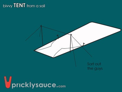

The sail I used came with two large metal rings which fitted perfectly over the top of the metal stakes.

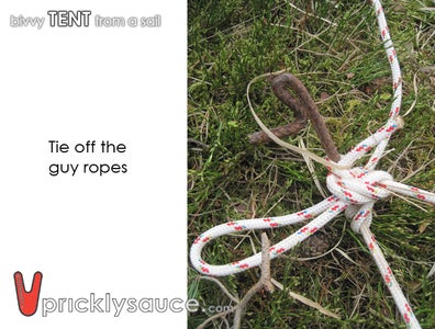

Attach the marine rope to the ring, two per ring to make one set of guys for each end.
I decided to splice the rope around the rings as it looks great and I wanted to learn a new skill.
Check out this YouTube tutorial to learn how to do it, it taught me all I needed to know.
Alternatively you could just tie a bight [loop] half way along the rope and hook it over the top of the stake.

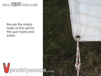

Tie thinner guys to the sails eyelets as needed.

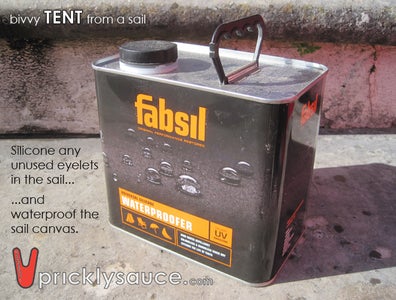

Sailcloth is not waterproof, it is a tightly woven fabric and so will shed water. To improve the fabric apply by brush a waterproofer.
Go around the tent and add silicone mastic to any eyelets that you don't require.

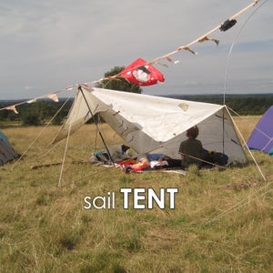

Step 5: Pitch the Tent
Get out into the great outdoors and pitch your funky tent.
Lay it out flat.

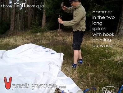

Hammer in the two end stakes.
Hook the sail over the stakes.
Hammer in the tent pegs and tie off the guy ropes.
Peg out the tent base.

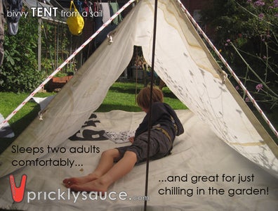

Support the mid way point of the tent...
...cut a length of square timber to fit inside the tent against one wall of the tent, cut a notch in it so the paint roller handle will fit against the other tent wall. The bolt on the end of the handle pokes through a small eyelet in the apex of the tent.
All ready for a good nights rest.

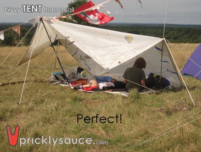

Step 6: Sun Canopy
This tent is great in the day too...
Un-peg the side of the tent and use an adjustable [telescopic] paint roller handle to make a long tent pole.
Add a bolt to the end of the pole [removable so that the handle can be used to paint a ceiling!] so that it can poke through one of the sail eyelets.
Attach some more guy ropes and peg out...
Now you have the perfect place to chill out on those sunny days.
