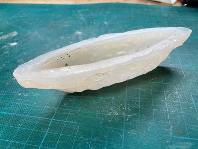

Step 2: Mold Making Using Hot Glue
In order to get a fine surface structure and that the original can be used various times the wooden original is covered with a balloon. Glue to covered hull to a piece of scrap wood. Protect the working surface of the scrap wood with some tape and glue the boat hull on top of it. For easy removal of the mold thereafter, the boat hull is covered with soap. Evenly distribute the soap with a paint brush. Then cover the original with hot glue completely. This take quite some time. Try to prevent the inclusion of air bubbles. Let the hot glue dry completely. You can also cover the structure again with hot glue to reinforce it. After the hot glue has completely hardened we start peeling the original out of the mold. As the hot glue is quite flexible it is easily possible. However the removal of the balloon that is sticking to the mold take a little longer.

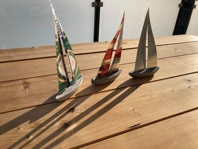

Step 6: Finish Sailboat Decor
Finally add some hot glue to the slots and fix the sails - your sail boat decor is ready.
