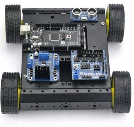

Introduction: SainSmart Car With Bluetooth
In this instructible I continue on the project in SainSmart Car Kit Instructions and I added a HC-06 Bluetooth Module to the Shieldv5.0.
Tips for Building:
- Build the car (metal pieces in the kit) around the wires built in SainSmart Car Kit Instructions
- Make sure the wires are secure (with electrical tape or solder) before putting everything together
- Keep the Car "on blocks" when testing (so it does not roll away)
Materials needed are:
- The materials listed in the Car Kit Instructions before
- HC-06 Bluetooth Module (or HC-05)
- At least four Female to Female Jumper Wires
- Some Female to Male wires
- Three 10K Ohm resistors
- A breadboard
- 9V battery and connection for ir
Step 1: Connect the HC-05 (Power and Ground) to the Shieldv5.0
     To connect the first part follow the wire diagram above.  Start by connecting the + and - pins on the Shieldv5.0 to the VCC and GND and HC-06.  Then connect a male to male jumper wire to the GND and VCC on the Shield to the  end + and - slots in the breadboard (as seen in the diagram).
Step 2: Connect the HC-05 Rx to the Breadboard
     Continue to follow the wire diagram for the Bluetooth.  First, connect a female to female wire from the Rx on the Shield to the Tx on the HC-06.
     To connect the Rx connect a female to male wire into the Tx pin on the Shield and connect the other end into the breadboard.  Then connect a 10K Ohm resistor right above that slot a couple slots away and connect the other end into a slot parallel to that slot.  Connect another female to male right above that slot and connect the female end to the HC-06.  Then make the voltage devider by connecting to 10K resistors or a 20K resistor (like in the diagram) and then use a male to male jumper wire and connect it to the ground row in the breadboard.

Step 4: Any Problems
If there are any problems look at these tips:
- If the light is not on on the L298N or Arduino check that all the wires inside are attached correctly
-  If the wheels will not move first check that the light on the HC-05 is not blinking (meaning that it is connected. Then, if it is not        blinking then check the code.
- Make sure that the 9 volt battery is connected to the Arduino UNO and the battery pack is connected to the L298N (otherwise the connection will not work)
