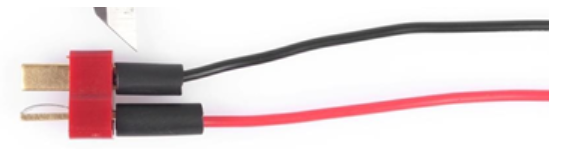

Now, you will need to solder a few pieces in order to build this robot, so if you are unfamiliar with how to solder, I suggest checking out noahw's Instructuable (https://www.instructables.com/id/How-to-solder/ ); it is extremely thorough and very informative. The first things you will have to solder are the two resistors and wires, which you will attach to each of the motors, as shown in the first picture.
Next assemble the T-connector (shown in the second image), and connect the black wire to the GND port on the L298N (the board that
sends information to the motors), and the red wire to the port labeled VCC. Note that this usually uses an 11.1 V Li-Po battery, but you can substitute that for a 9 V battery, using a second set of wires. Wrap the copper around the prongs of the T-connector, and then around the corresponding positive (+) and negative (-) parts of the battery. Be sure to wrap the exposed wires in electrical tape for security and safety!

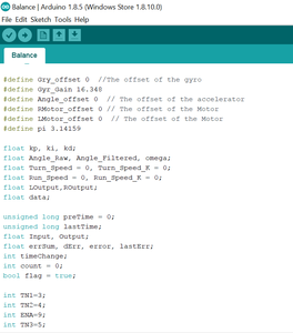

First, it is important to note that your robot may not balance right away (mine certainly didn't). However, it should at least be trying to keep itself upright. The Balance.ino file is essentially the source code but stripped down to the basics of the balancing program. In this code, however, the potentiometers are unnecessary because the values from them are inputted manually (these are the kp, ki, and kd values you can see in the image above).
If your robot is jerky or unstable, first try playing around with these values; they can usually fix a lot of problems. Additionally, you may want to see what changes the variables defined at the top have (see other image). For my robot, I had to adjust the angle offset and the RMotor offset, but yours may be different.
Once you have your robot balancing effectively, download the Trust_Fall.ino file and adjust all the variables according to your robot. Look at the flow chart below to get an idea of what the code is doing. Essentially, it will balance normally for 9000ms before turning on both LEDs. After 1000ms more have passed, the lights will flash, and the robot will fall down (try to catch it!). When you pick it back up, it will just balance normally indefinitely. If you want to do the trust fall again, just press the reset button and wait a second.
