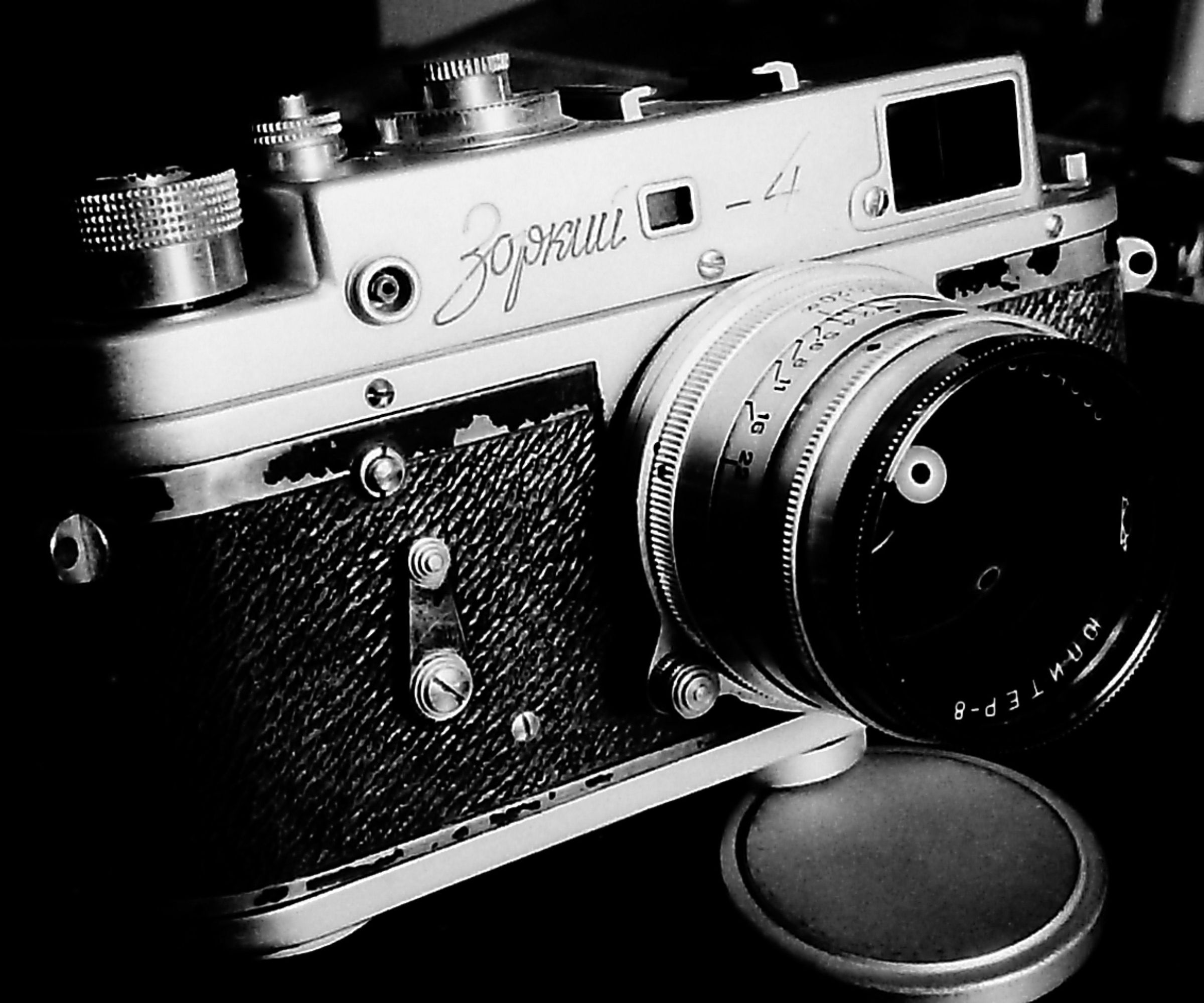

This is a russian made Zorki 4 rangefinder camera from 1960 with a Jupiter 8 lens. Notice the even rich lighting and the magazine appearance and we did it with a salad bowl ,B&W paint, a tin can lid and some glue, nuts bolts and some brackets. Color photo taken with Nikon d100 DSLR and B&W shot with Nikkormat FTn film camera -Arista EDU developed in minimal no sulfite phenidone formula
To compare prices, a store bought beauty dish would run you $36-$90 on ebay
