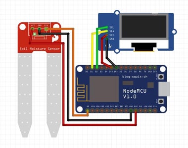

Step 1: Setup
Follow the layout in the illustration:
The sensor is connected to 3.3V and GND on the Arduino/ESP, the data line is connected to A0.
The display also is connected to 3.3V or 5V and GND, SDA --> D1, SCL --> D2
