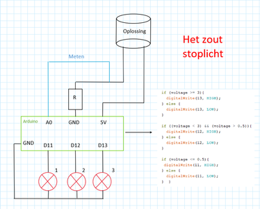

Step 1: Assemble Circuit
Make a circuit with the Arduino and breadboard like the one in the picture:
- Connect two electrodes of choice, one to the 5V pin of the Arduino and one to ground. The wire going in ground needs a resistor.
- Add a wire from the groundwire to an analog pin in the Arduino.
- In another circuit, add three lights in parallel. Use pins according to preference and the ground pin.

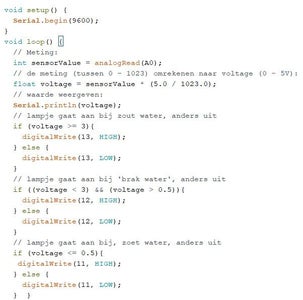

Step 2: Program
Write a program in Arduino that measures the Voltage over the electrodes.
Make three voltage intervals with the values from the picture above. The lowest values turn on the first light, the middle values turn on the second light, the highest values turn on the third light.
Make sure you use Alternating Current, otherwise the resistance between the two electrodes keeps increasing which messes up your measurements.
