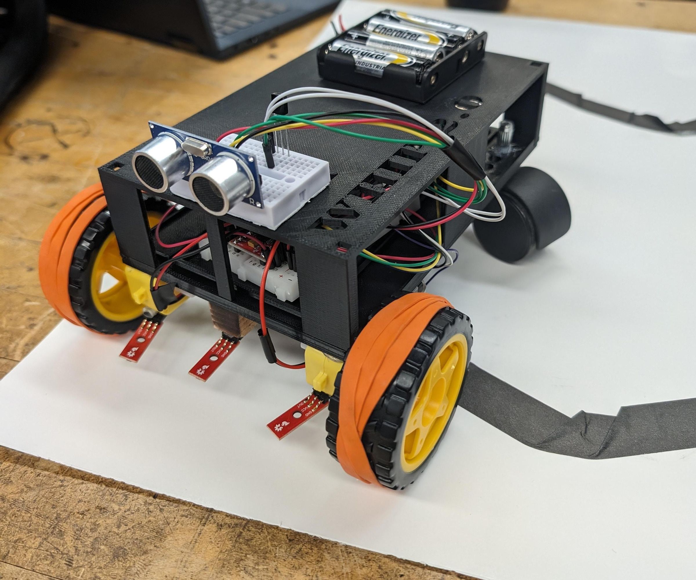

Step 1:
  1. Using a hot glue gun, glue the printed parts together. The names of the parts corelate to their position.
  2. Attach the 20KG Servo to the chassis of the tank motor.
  3. Attach the 3D Printed assembled head to the 20KG Servo.
  4. Wire the sensors and motors to the breadboard and Arduino Mega.
  5. Complete build setup.
  6. I could not get the 20KG Servo to function properly, so was unable to test the project out.
  7. Next Steps
  8. Get proper power to 20KG Servo and begin testing prototype.
  9. Add IR Remote for commands such as "Salt," "Pepper," or "Stop."
