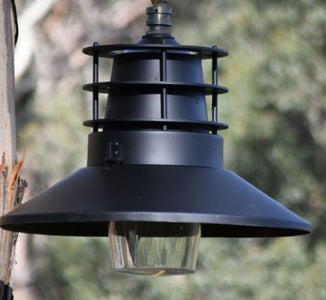

Introduction: Salvaged Street Light Conversion

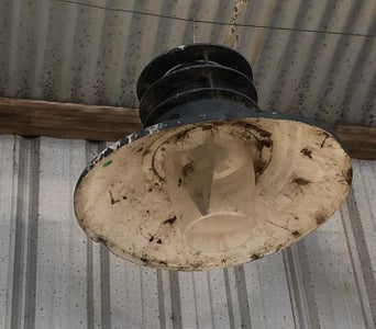

I salvaged a few decommissioned street lights from our local tip — battered but mostly intact. I suspect they once lit the main street of our town, and now they’ve found a second life as garden features. A bit of restoration, some creativity, and they’re back in action.
Old banged up street light/s

Step 1: Clean Up
The first step is to clean the street lights up.
Using a small hammer with a rounded end, I gently tapped them back into shape. Since they're made of aluminium, it wasn’t too difficult to get them reasonably straight. For the edges, a small spanner worked well to press and bend things back into line.
Once reshaped, I sanded the entire surface with 240-grit sandpaper to give the paint a good surface to adhere to.
  1. Exterior: spray-painted in matte black
  2. Interior: finished with a matte burnished copper spray for contrast and warmth

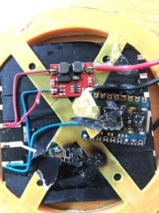

Step 3: Electronics
The electronics setup is fairly simple. I used an 8×8 LED matrix so I can fully control the colour temperature and create custom lighting effects.
You'll need a DC-to-DC converter that matches your input voltage and is rated for the power required at full brightness. In my case, the module is quite small since I never run all the LEDs at full power.
Important: Don’t rely on the onboard voltage regulator of your dev board to power the LEDs — you may end up like the second picture...
Before wiring everything in, make sure to complete the next step.

Use hot glue to fix the DC-DC converter and microcontroller to the back plate.
Make sure all wiring is secure and insulated (I used electrical tape on the back of the board).

Step 8: Mounting
I used gal water piping and elbows to get the bracket look and function I wanted. Standard plumbing bits were used to attach to the light to the gal.
Step 9: Finished Pics
