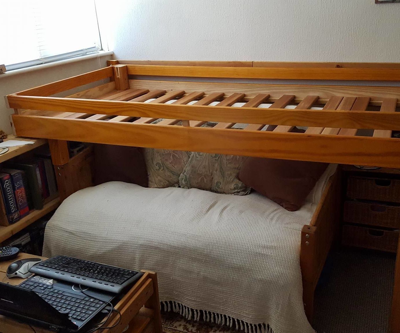

A few weeks ago our friend Reg asked me to make him a table to replace the damaged middle seat of a corner suite he has.
The brief was fairly straightforward, it had to measure 24" x 30" and be 20" high, materials or finish were not important as it was going to be painted white; all he really wanted was something to put a lamp & his laptop on.
Anyone who has seen my previous 'ible about furniture I have built will know I am a great fan of recycling & salvaging so this seemed like a good opportunity to give a new lease of life to some timber I had acquired from one of the members of my local Freegle group a couple of months earlier when I was building some beds for our grandsons.
One of the beds was a standard 3' single, the other was essentially a mini version custom built to fit into our bedroom alongside our bed for our two year old grandson Ryan to sleep in when he stays over, my better half Joanie calls it "his three bears bed" not too big & not too small but just right.
Some of the donor timber for these came from a set of 2' 6" bunks & I still had some of the mattress slats which were of course 30" long so it seemed fated that they should continue their working life as a table top.
These along with a few other left overs from the bunks as well as the remains of the legs became the core of Reg's new table.
As I said Reg's brief was quite straightforward, however as I was sketching out ideas in my head that evening I I decided to add a couple of things to it.
